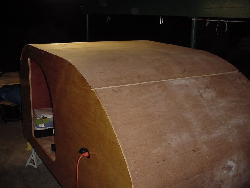

Postby Mary K » Tue Aug 21, 2007 3:14 pm
Pictures folks, Pictures!
I skinned the exterior with 1 layer of luan glued to the spars and stapled.
Then, I skinned with another layer of 1/8" 4x8 birch cut to 5 ft wide. I glued it to the luan and used ratcheting straps
to hold it down while it dried.
I hope This helps.

Postby mikeschn » Tue Aug 21, 2007 5:29 pm
Thanks for helping out with those pics Mary K.
