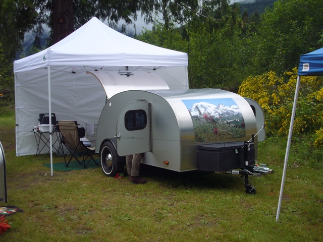

Postby pgwilli » Tue Aug 21, 2007 10:04 pm
I never concidered the tongue box part of the tear, so I bought an off the shelf ABS unit.
I'm sure I didn't pay $80 for it , delivered.
Rocks bounce off, no finish to worry about, but I have seen much nicer units...with all those concerns :lol:
Paul, Norma & the Girls
2014 Escape 21
2006 Chevy Trailblazer
