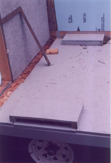

Was in Menard's the other day and found 4x8 1/2" and 3/4" sheets of recycled rubber composit . This would totally eliminate the dredded floor rot and the black goop exercise. I wish I had known this was available in April when I built my floor. I did get some for the galley floor as a floor covering and am considering building up the sleepy side floor 1 1/2" with foam and then a floor of this to eliminate the wheel well lumps. If you are starting a floor take a look at this stuff It would be water and mud proof and easy to clean as a finished floor inside and as a under side should be bulletproof. Thought I'd pass it along ......

Postby bobhenry » Thu Aug 23, 2007 12:23 pm
Geron wrote:Maybe it's this stuff
http://tinyurl.com/34epy7
Caution: PDF file 1.59M -- slow to load
Geron
I went looking after my initial post and I found this sight also . I coouldn't tell if this is exactly the same product. What I saw was predominatly grey with a fleck of red and blue in it. I kinda reminds my of that epoxy garage floor finish in grey. I'll snap a shot of the stuff I have at home with the old 35 mm. It'l be a few days but I will follow up.

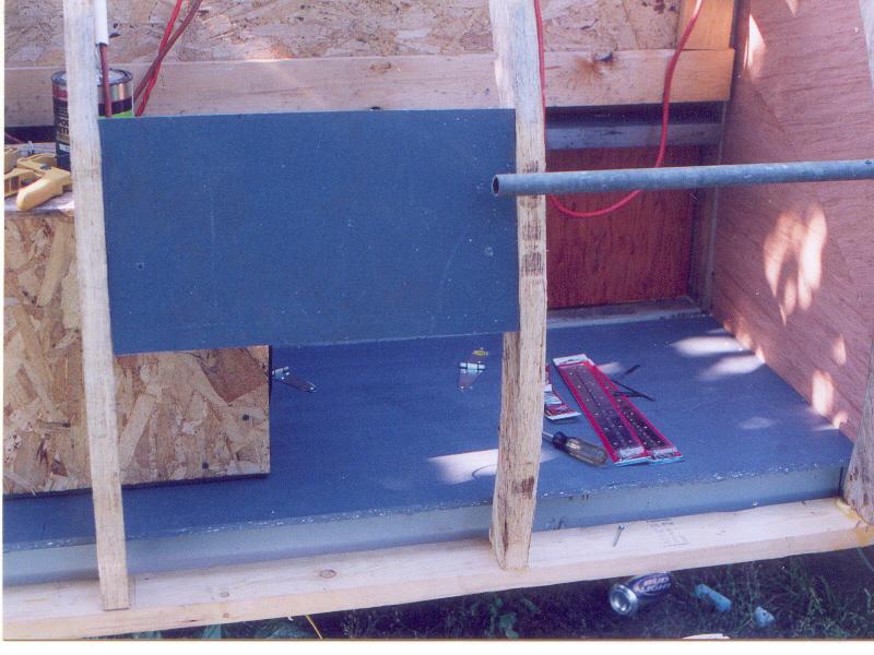

Postby bobhenry » Mon Aug 27, 2007 9:50 am
http://www.tnttt.com/gallery/image.php?image_id=25808
I had a picture sorry it not a close-up.
This is the 3/4 piece that the previous owner had installed on the 4x8 hf trailer I bought off of E-Bay. I cut it with a circular saw and installed it as the floor for my galley area. The big dumb lookin' pipe on the right is just that , a pipe clamp.
The floor is also painted gray so you have to look close for the specks in the rubber sheet.
Postby madjack » Mon Aug 27, 2007 10:13 am
Bob, how ridgid is it compared to, say that piece of wafer board sittin in the galley......................... 8)
Posts: 15128
Postby bobhenry » Mon Aug 27, 2007 12:43 pm
The 3/4 is probably as ridgid as 1/2" osb. I intend to purchase 2 pieces 1/2" thick sheets ( unless the price scares the Hell out of me) and will use it as the finished floor in my 5x8 over the foam to level out my floor. The fooler is I think you could bend it (with extreme difficulty) to almost 90 degrees . Try that with osb or plywood. I learned to wear eye protection when cutting it, it's like setting in the 3rd turn at Daytona rubber crumbs flying ( bouncing) everywhere.
