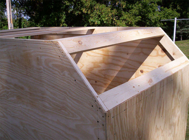

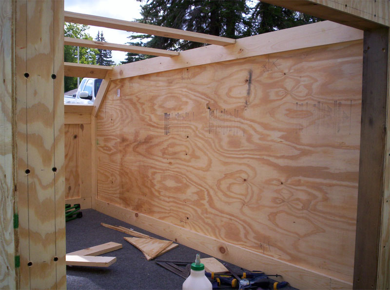

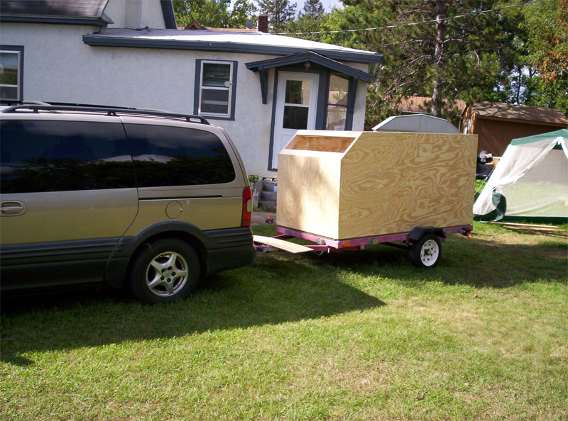

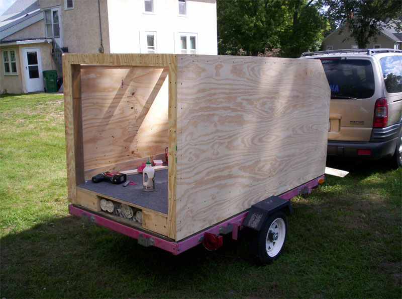

This is the ultra quick build of my "Race Coffin" as the brother-in-law and i are calling it. it's quick, easy and durable. It is made of 3/8 BC grade ply and 1x4 framing. the base is stout, it is 2x6 with 3/4 cdx so i can pull it off the trailer and still use it to haul around a 4 wheeler or snowmobile. Image
Note the hole in back by the floor. those are poles for a carport canopy that we pit under on race weekends. that is one reason i went with such a stout floor. and for the ability to pull the box off if i need just the trailer.
I will be adding some more framing to walls today. then i will add some 3/4 insulation, the inside will be luan finished with carpet, but that can happen after the exterior is done.
Thought of putting in a small lexan window here to let in some light.
Here is a question what type of resin do i use to fiberglas to wood? i plan on fiberglassing the corners and seams then coating the whole thing in a paint or durbak. This winter when i build the weekender i'll paint both trailer frames.(one mess two projects).
To the point you now see the trailer i have 5hrs into it. and i hope to finsh it with 15hrs total. it helps that i spend all day building homes and this is as simple a design as you can get. But it has to be ready to go the weekend after labor day on a trip up the north shore of lake superior. the wife said this is what she wants to sleep in instead of a tent. so that will be its madien voyage.

Postby madjack » Sat Aug 25, 2007 1:22 pm
Felix, a lot of the strength in a TD come from the internal bulheads of which you only have a front one...it looks like you have a pretty stout build but I would consider putting a couple of 8-12 inch gussets...these would help offset the "racking" forces a TD experiences while travelling down the road...one set in the middle and one set in the rear...I would also recommend epoxy resin witha standard hardner from www.raka.com

Postby moto403 » Sat Aug 25, 2007 1:40 pm
I was planning on building an aluminum square with an x-brace out of 1 1/2 inch tubes that i could rotate up to the ceiling so it was out of the way when i use it to sleep and rotate down during transport for side to side support. just behind the roof vent as close to center as possible.

Postby madjack » Sat Aug 25, 2007 1:48 pm
moto403 wrote:I was planning on building an aluminum square with an x-brace out of 1 1/2 inch tubes that i could rotate up to the ceiling so it was out of the way when i use it to sleep and rotate down during transport for side to side support. just behind the roof vent as close to center as possible.
...that oughtta work.............................. 8)

Postby GPW » Tue Aug 28, 2007 6:55 am
Moto , that aluminum square thingie sounds complicated and cumbersome to use ...what if it comes loose in the middle of the night and knocks all the pieces off your Parchesi board ??? :roll: .... Mad Jack's gusset idea is so much simpler and secure... we used a curved arch across the middle of ours , great strength and allows hanging a curtain for privacy ...
Postby moto403 » Tue Aug 28, 2007 11:05 pm
I went with two 8 inch gussets in the rear. i may add your arch idea to the center. Thank you i never tought of that.

Moto, we're intensely following your build , because we HAVE to build a similar cargo hauler in the very near future...Thanks for the 3/8" ply idea...ours would have been too heavy with scrap 3/4"

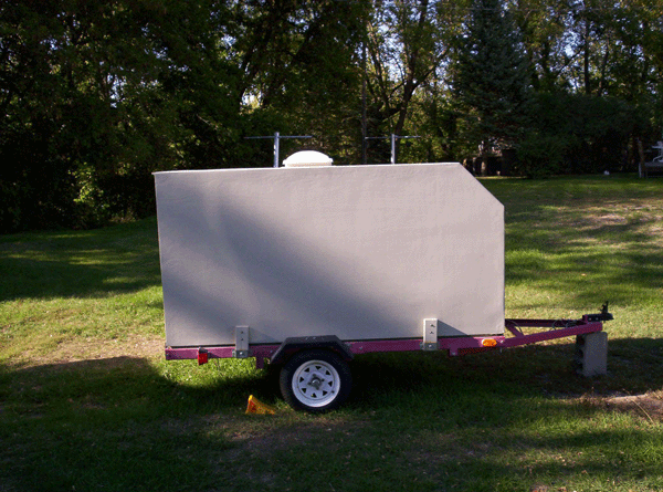

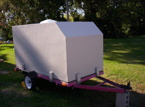

Well i finally got photoshop figured out here are the pics as of now. more to come after i can get it completed.
Here is a side shot. it is in need of some sort of graphic.
I didn't have time or money for a front window but i do have it framed for one.

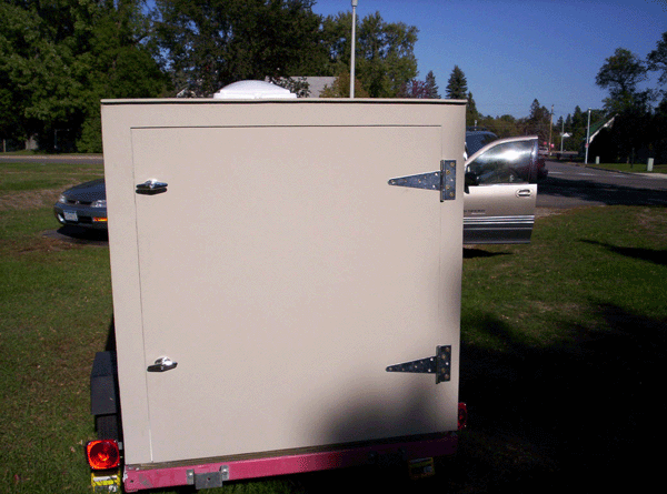

The back door is a simple cargo door style but it works great.
For the ceiling i used beadboard looking stuff. it looks nice and was only $17.00. it was backed with 3/4inch pink foam, glued and shot up with a brad nailer.

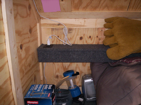

The inside is still unfinished but i put a small shelf in front (it can be removed) and that is where i located my outlet. the white wire is to the rope light i mounted by the ceiling on the left. it offers a nice soft light. and i also mounted two L.E.D tap lights front and rear of the vent for non-electric situations.
Last weekends excursion was a blast. it was so nice to be able to pull in at dusk, unhook and be setup in five minutes.
We stayed warm and dry which is more than i could say about being in the tent. We still had our !st outing mishaps , but they were minimal.
My only regret was not making it 5 or 6 foot wide, but it will be just fine as a race trailer.
