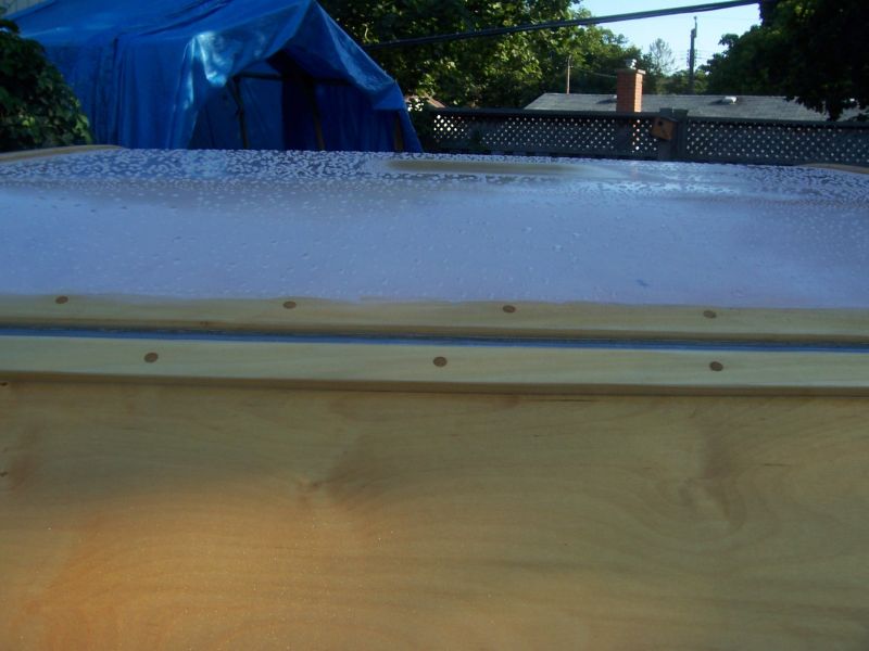

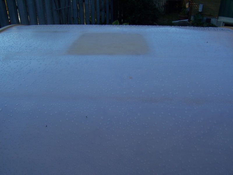

Postby Micro469 » Sun Sep 02, 2007 8:17 am
The tear was still tacky when I finished lasat night, so I just left it out.
I woke up this morning....and the whole roof was milky....
So How do I fix this????? And what caused it?

Postby Podunkfla » Sun Sep 02, 2007 8:55 am
John... the epoxy prolly wasn't fully cured. I noticed it didn't show up where the vent fan goes? There is a good chance sunlight will make the blush go away. I'd sure let it bake a few days before I tried anything else. Dang the luck... eh? :(

Postby Juneaudave » Sun Sep 02, 2007 9:07 am
I agree with Brick...that was moisture affecting uncured epoxy. I would let it set out in the sun, or maybe under a heat lamp for gentle warming. West Systems recommends:
PROBLEM: Clear coating turned cloudy.
POSSIBLE CAUSES & SOLUTIONS:
Moisture from condensation or very humid conditions reacts with components in uncured hardener.
Apply moderate heat to partially cured coating to remove moisture and complete cure. See Out-Gassing caution in User Manual.
Use 207 Hardener for clear coating applications and for bonding thin veneers where epoxy may bleed through to the surface.

Postby Alphacarina » Sun Sep 02, 2007 12:51 pm
Epoxy blushes (turns opaque) with just high humidity . . . . it doesn't even need to get wet

Postby kirkman » Sun Sep 02, 2007 1:28 pm
Alphacarina is right it is normal for epoxy to blush like that in a high humidity. Let it bake in the sun or in a hot garage (sun it better) then sand and re-coat. I would not recommend doing a hot coat because a batch with more hardener in it will make the epoxy softer/weaker. I learned that the hard way making boats.

Postby angib » Sun Sep 02, 2007 4:28 pm
Ken J wrote:If for any reason it does not cure - you can do a "hot" coat over it and it should cure then - by hot I mean little more hardener.
No, no, no - that is good advice for polyester, but it's all wrong for epoxy.
Do not alter the hardener ratio on epoxy or it will certainly fail to cure even if everything else is perfect.
You cannot apply a 'hot enough' layer of epoxy (which would require a different, super-fast hardener, used at the manufacturer's ratio) fast enough to get it applied before it gels - epoxy doesn't exotherm enough to do that.
Heat lamps or just strong sunlight for several days are your only hope. It wouldn't do any harm to wash down the epoxy with hot detergent which will wash away any amine blush on the surface - it won't cure your problem by any means, but it might reduce it a bit.

Postby Micro469 » Sun Sep 02, 2007 7:24 pm
O.K. guys... Here's what I did......I sanded....and sanded,,,,and sanded some more.I got most of it off, and started to reapply a new coat of epoxy...noticed a couple of areas where it was still cloudy, and stopped. Tomorrow I will continue to sand until I am sure it's all off. Then I have to wait till next week to reapply because.........wait for it.........
I RAN OUT OF FREAKEN HARDENER!!!!!!! :? :x

Postby Micro469 » Mon Sep 03, 2007 7:29 pm
I had enough hardener in the bottom of the can for one more batch. After sanding the roof again this morning, I applied the epoxy. It came out well.
I now have a roof I can be proud of......again. :thumbsup:
