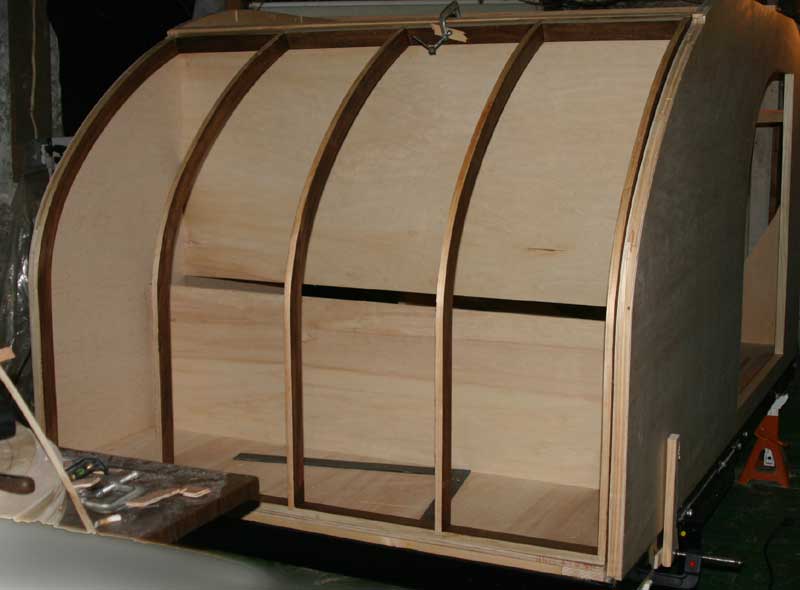

In my work I build lots of curved walls, etc. If you go with the horizontal framing you'll most likely have some flex/racking unless you layer plywood to 3/4" thick to make it not flex/rack. If you cut radius framing to match the profile of the hatch you have more integrity in the structure and can use a thinner layer of plywood. They all need some cross bracing. This picture is of my slightly less than 5' wide hatch. The extra corner blocking is for tail lights and license plate light mounting. I could have used less ribs, next time.:D Danny
P.S Think of the ribs on your body, they curve to match the contour and are very strong, why not make your hatch the same way, it's a proven design. :thumbsup:
