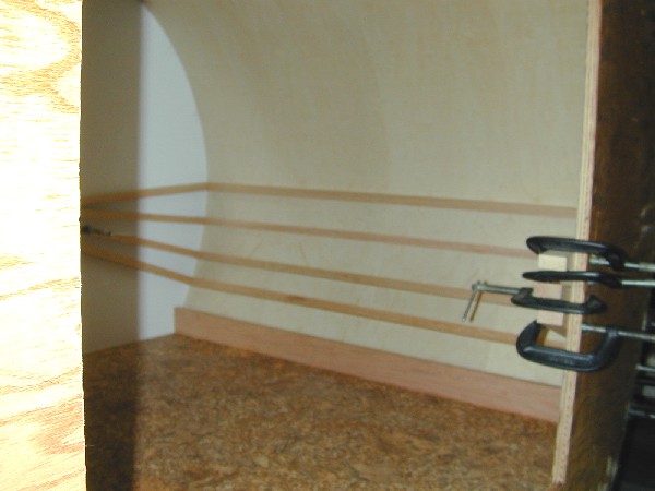

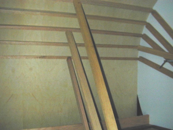

Have been slowly fitting, gluing and screwing my ceiling into position...
I'm doing a couple of sections (Spars and blocking) per day... This is day three...
Using temporary blocking inside the cabin to hold the 1/8" maple plywood in position while the glue sets up...

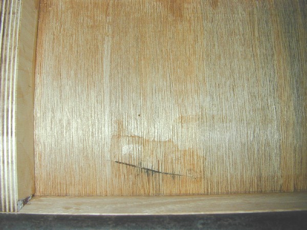

Well... I was getting ready to add another spar and corresponding ledger blocking when all the sudden I heard a loud CRACK!!! :o
Upon further review I discovered why and what happened...
This 1/8" maple was the finset stuff I could find and it wasn't cheap, about $40 per sheet. The maple side is very nice... Nice grain and bookmatched to boot, but...
The backside is piss poor garbage wood as far as I'm concerned.... crappy grain, voids and little black worm holes in various spots...
This worm hole is where the problem occured... it cracked the backside of the plywood at each end of the hole.
(Something to check for on future ceiling plywood purchases)
Fortunately, the maple side didn't crack, but there is a small facet there right now... And it happened in the area that I'll be installing a front upper shelf.
When the glue on the closest spar is cured I'm going to install some additional blocking to hopefully get rid of that small facet on the interior side and get back that nice radius, if not, I'll install the shelf right over the top of it...

Postby Dean in Eureka, CA » Mon Sep 10, 2007 12:38 am
The worm hole has been dealt with and I'm happy to say, I got the radius back on the interior side and no sign of any deviation, plus the block will work good for attaching the shelf.

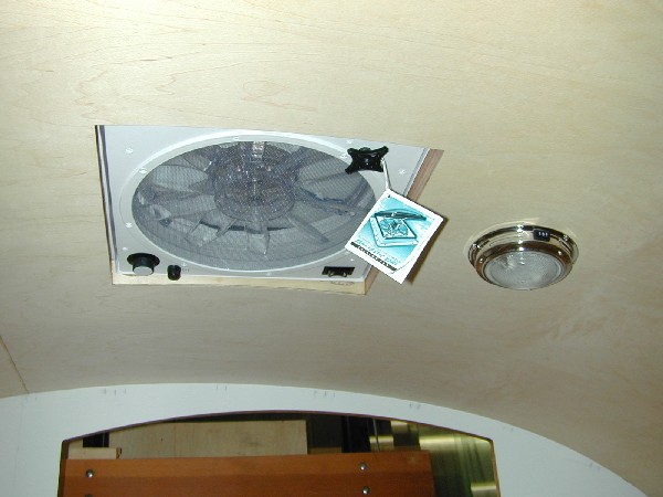

Postby Dean in Eureka, CA » Mon Sep 10, 2007 7:09 pm
Just about got 'er...
Blocking as we go...
Set the fan in the hole and mounted the light...
I'm looking forward to playing with my exterior skins... :twisted:
