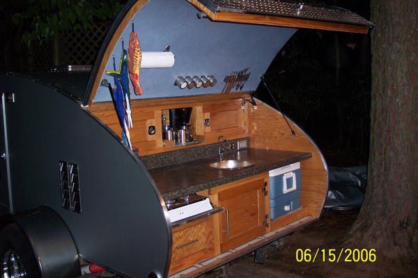

Gerdo wrote:I just layed on a few heavy coats of exterior spar poly.
Gerdo I must say that Galley looks very nice...Are ya coming this way by chance? :lol: :lol: :lol: :thinking:
Well looks like Ive got that area covered then without really even knowing..Hmmmmmm.
Thanks Gerdo
