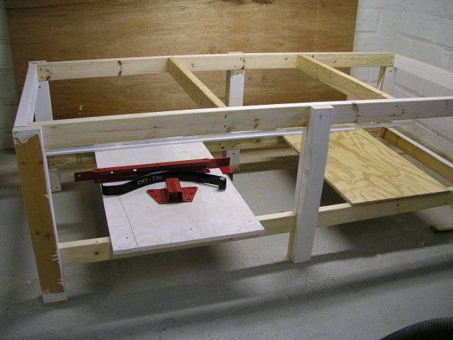

I built a simple sturdy table in the basement to build the ultralight on. I'll see if I can find a picture.
I didn't figure I needed a table for the ET, since I was just cutting out 1/2" plywood. I glued the pieces together on the trailer floor, and then lifted them up into place.
P.S. Ah here it is, before I put the top on it...
