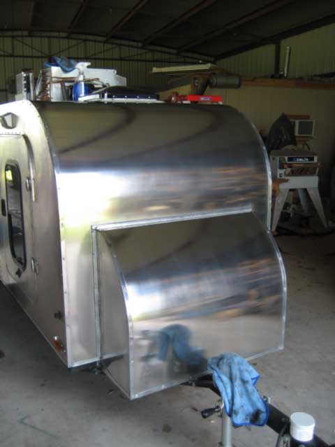

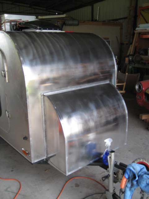

Here are the results of this weekend's sweat and mosquito bites:
Tackled the roof, front, and tongue box.
Another angle of the same thing:
You can see the effect of the compounding step in those photos. What I am doing is 2 passes using the compounder and Nuvite F7 (am I starting to sound like an infomercial for F&?) and then one pass with the Cyclo and Nuvite S. The swirl marks mostly disappear with the second pass and the pass with Nuvite S.

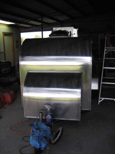

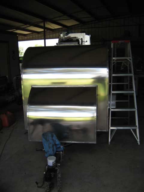

I spent today finishing the compound step on the roof, front and tongue box, then one pass with the Cyclo and Nuvite S. This first shot looks great:
In reality, it doesn't look quite that good. Here is another angle
As you can see, it's not perfect, but as I said previously, I'm not going for a perfect finish. This is close enough for now. Maybe someday I will go for a perfect reflective surface with no scratches, swirls, or streaks. It would probably take another half dozen passes for that. But not in this heat and humidity.
