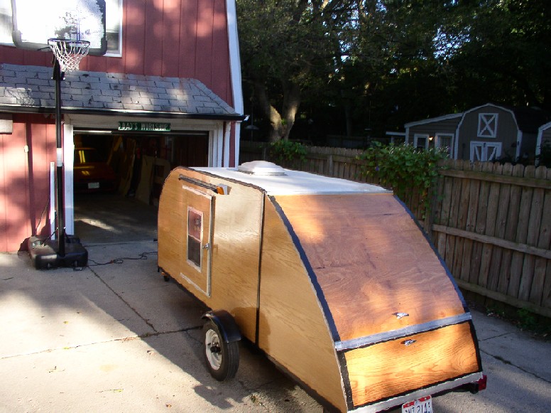

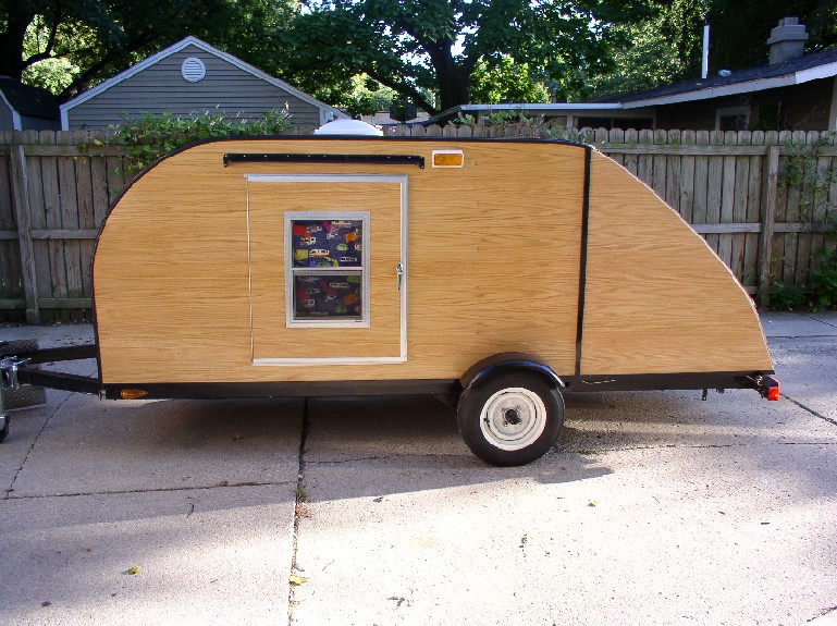

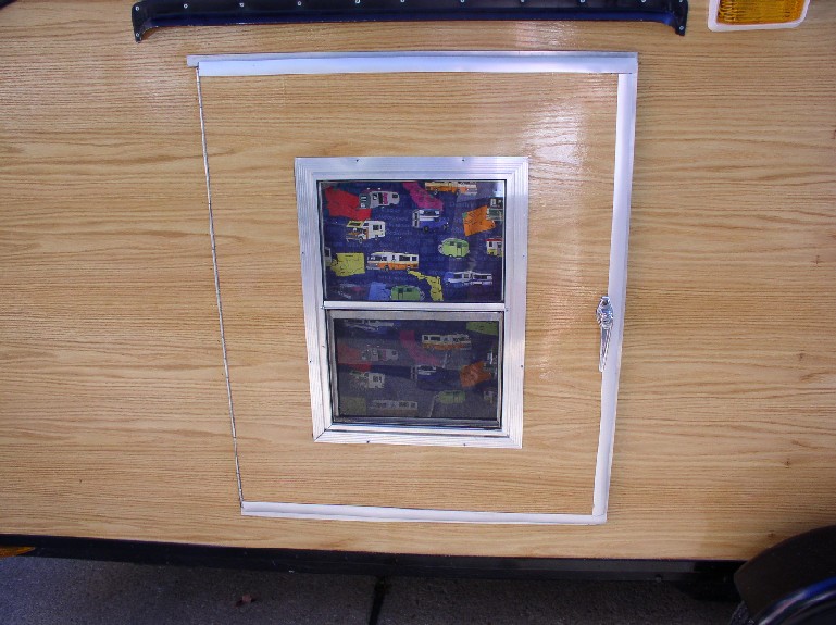

I am done with my new woody skins & new hatch. Let me know what ya think. It took about 2 months to do. I am going camping this week at
Harrison Lake State Park in Ohio. Here are a couple before pics , then a couple after pics.
Now the "NEW" - " Dew Drop Inn "
So ,,,,, ?????

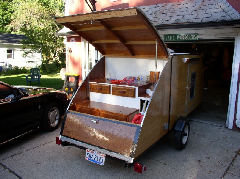

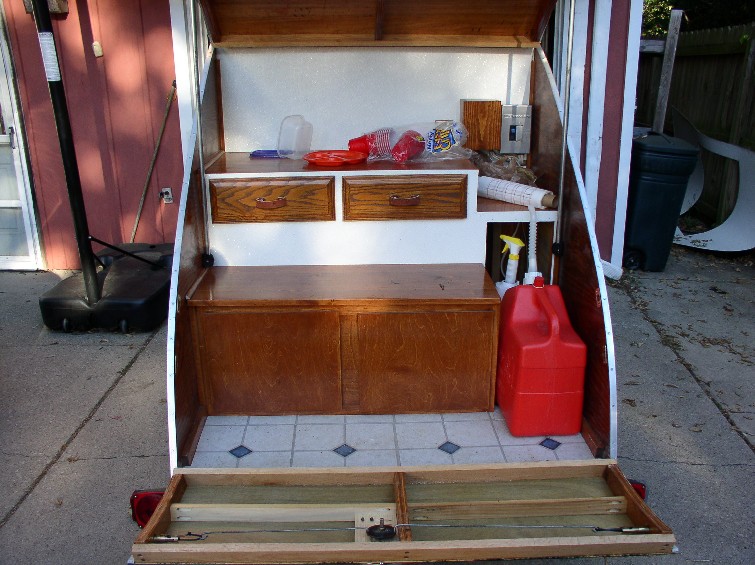

:P :woohoo: :beautiful: :clapping hands: Looks great Boodro! How about some pictures of the hatch up. Do you have two hatches? :thinking:
:thinking: Doesn't look shorter. :)
Postby Boodro » Sat Sep 22, 2007 10:58 pm
Thanks Aunti M, Yes both hatches open. I did it that way because my old hatch was too heavy! :( I still needed to access the cupboards below my lower counter so I had to make a small hatch on the bottom . I only drop the bottom 1 when I have to access my pots & pans. Most of the time it will be closed , while the top hatch will remain open. I will have some pics added soon, I did not think to take a pic with it open today. I did not shorten the trailer as I originally thought I would. I did redo the hinge area & make the transition from top to hatch a little softer . Also it seals better now at the hinge . :thumbsup: I will be changing my taillights this winter too. I have 2 flush mount oval taillights that will be mounted in the lower hatch. I can't tell you how many times I have cracked my shins on the ones I have now!! :x :x :x They stick out from the trailer about 6 inches & when I walk around the corner ..WACKO !!! :cry: :cry: Boy that hurts!

Really like the two hatch idea. And also the "RV" curtain.

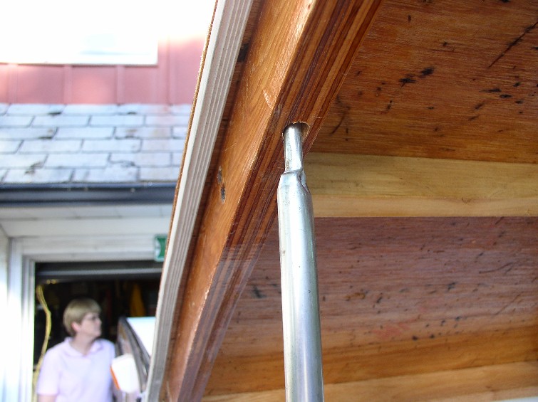

Aunti M , here are a few more pics with the hatches open.

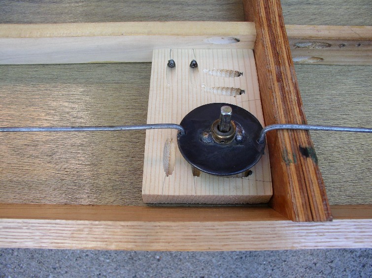

How my latches work
[img]http://www.tnttt.com/gallery/image.php?image_id=27388[img/]

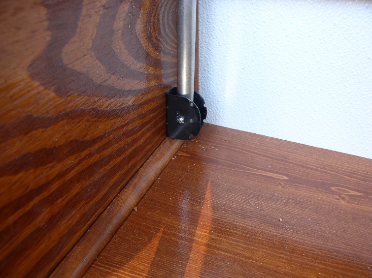

My hatch supports

Looks Great! Looks better with the woody look IMHO. I also like the metal on the front to deflect road debris, nice touch. :thumbsup:
