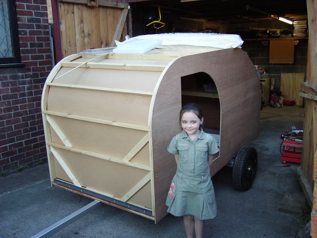

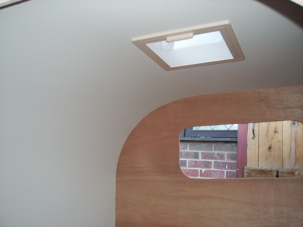

After a few weeks of not posting I thought I`d bring you up to speed with my build, plus the bubble oil was slipping, so here goes.
Phew, glad ive finally got the hang of cut and paste :lol:

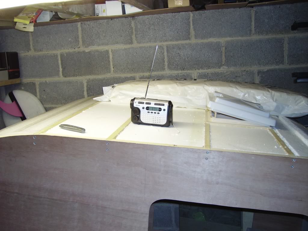

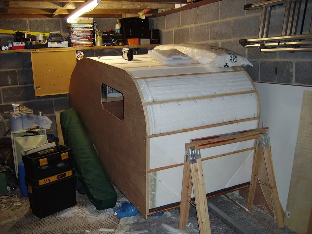

note the pic of my new best friend. the trusty radio. The last pic was taken last night just before midnight, have to empty garage to work on the trailer so wanted to get hatch frame finished before I had to put everything away again

Greetings from Finland....Beautiful Work youve done ... I see the little one is supervising your building.. :) :applause: :applause: :applause:
What kind of insulation is that? Looks easily bent to radius ?
You wouldnt mind if I fly over some weekend to take a look see at your tear? :lol: :lol:

:beautiful: :woohoo: Wonderful---neat construction. You have done a great job with the TD. And Kudos to the little one. Bet she is a great help. Do they give badges for helping with Teardrop building? 8) ;)

The insulation i begged and borrowed from various sources. I used expanded polystyrene for the fla areas and on the curves i used 44mm thick packing pads that are used when transporting car body panels, I got them from my local BMW dealers parts department.
The trailer I hope will be quite light, every part is structural but as light as poss. I am 5`4" and 10 stone but I can easily lift the chassis clear of the floor ( obviously its heavier now!)

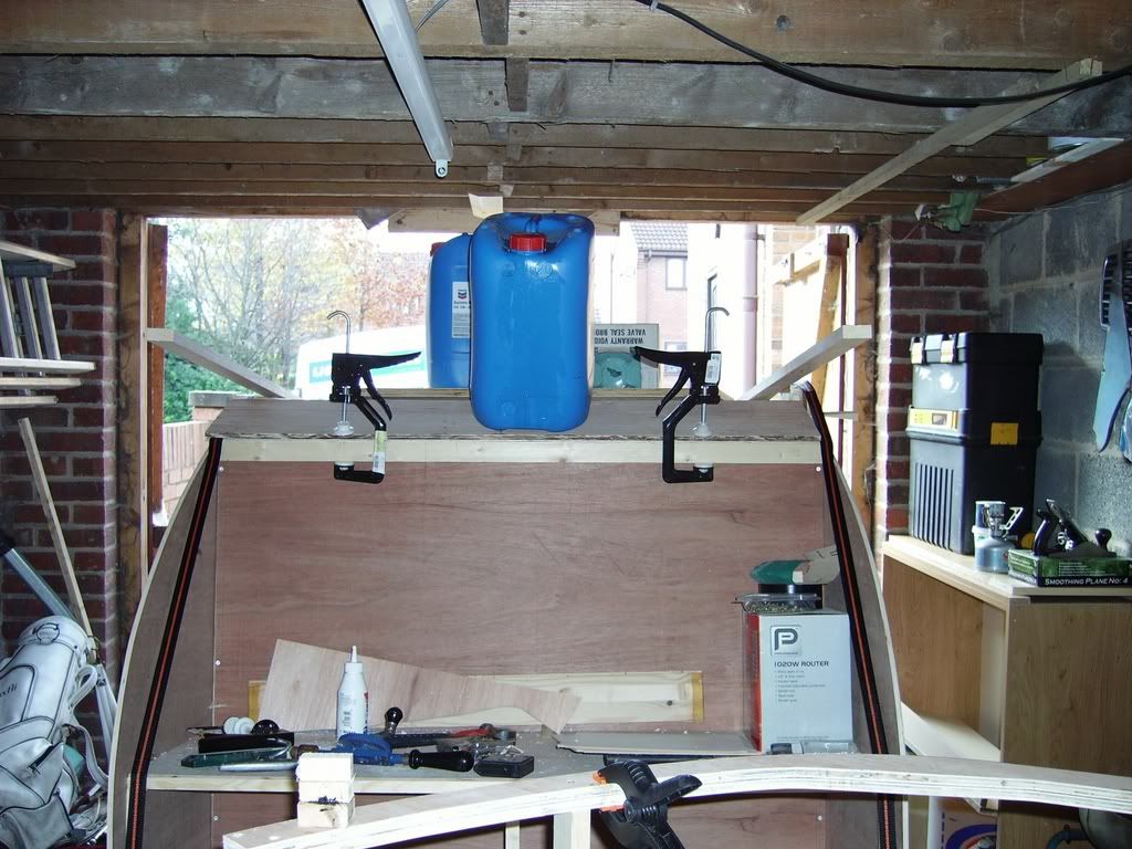

more build progress pics.

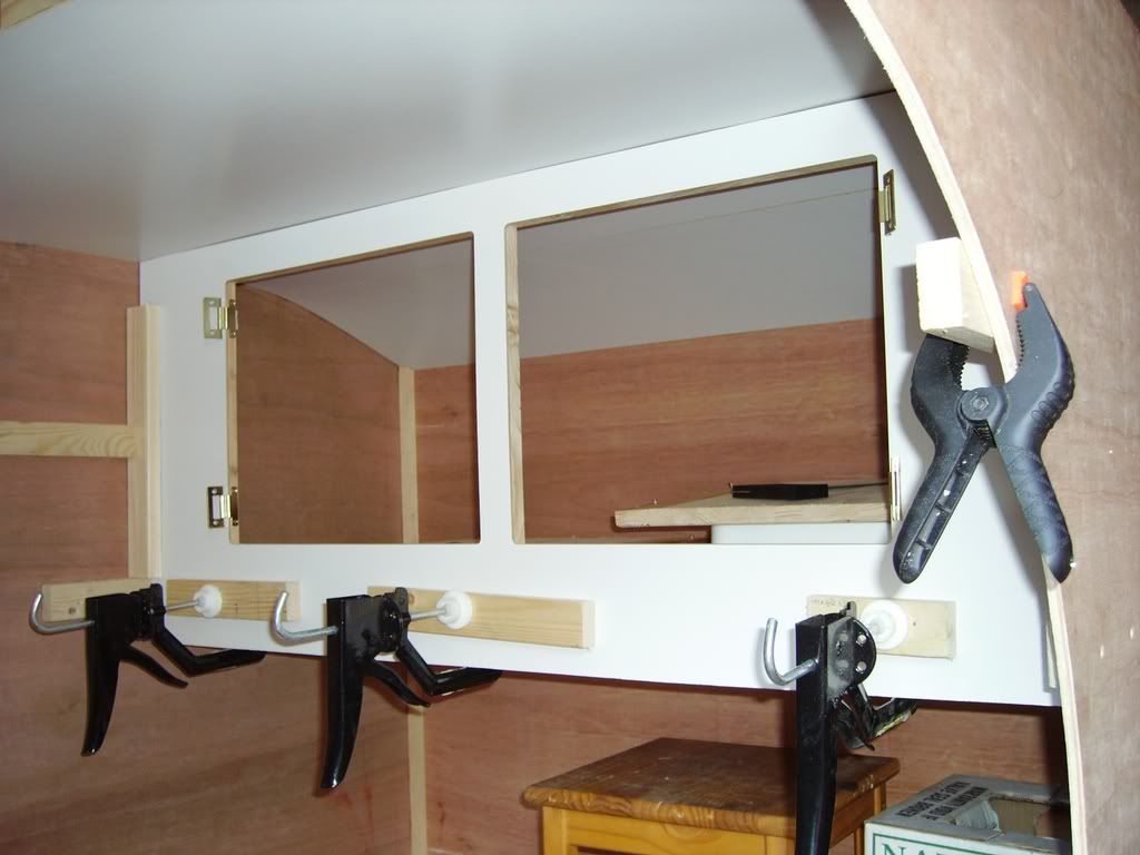

Love those "calking gun" clamps. Never seen them before. They look commercially made. The wheels are turning. Any one ever seen these in the states?

Ralf wrote:Love those "calking gun" clamps. Never seen them before. They look commercially made. The wheels are turning. Any one ever seen these in the states?
Hey Ralf, the clamps were a bargain bin special, I got 6 for £5 at an autojumble, they work but can slip if clamped too tight, either way they were the same price for all of them as is the cost for one sash clamp 8)
