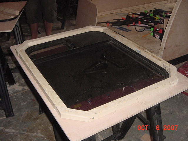

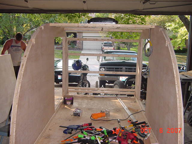

We got second wall up front spars and vent
also made first door

Postby Miriam C. » Sat Oct 06, 2007 4:52 pm
:woohoo: :clapping hands: :hammer:
Nice progress you got going there. :thumbsup: Would love to see the other side of the door.
Postby Tcurr » Sat Oct 06, 2007 5:39 pm
Heading out to friends for buckeye game but will post a pic of both sides of door tommarrow. Using windows from a shuttle bus. Got a really good deal on them.

Postby jeepr » Sat Oct 06, 2007 7:14 pm
Looks good! Those are some pretty substantial looking walls, how thick are they?

Postby Tcurr » Sat Oct 06, 2007 10:14 pm
Jeepr They are 1/2 oak on each side and 3/4 studing and insulation between. Being in Ohio wanted to make a 3 season so entire tear will be 3 season Insulated. Each wall is 1 3/4 I am really anxious to have it weighed becayse lifting the walls it doesnt feel that heavy.

Postby jeepr » Sun Oct 07, 2007 6:26 am
Tcurr wrote:Jeepr They are 1/2 oak on each side and 3/4 studing and insulation between. Being in Ohio wanted to make a 3 season so entire tear will be 3 season Insulated. Each wall is 1 3/4 I am really anxious to have it weighed becayse lifting the walls it doesnt feel that heavy.
Yeah, I found that in your other post. You will like the extra thickness when the weather turns bad. When I looked at it I thought it was two sheets of 3/4" ply. Now that would be a little heavy! :lol:
