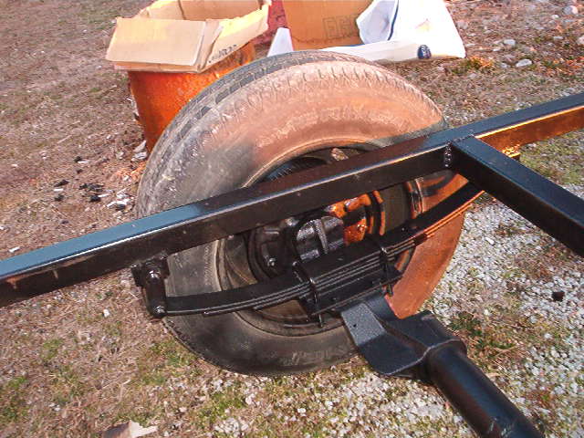

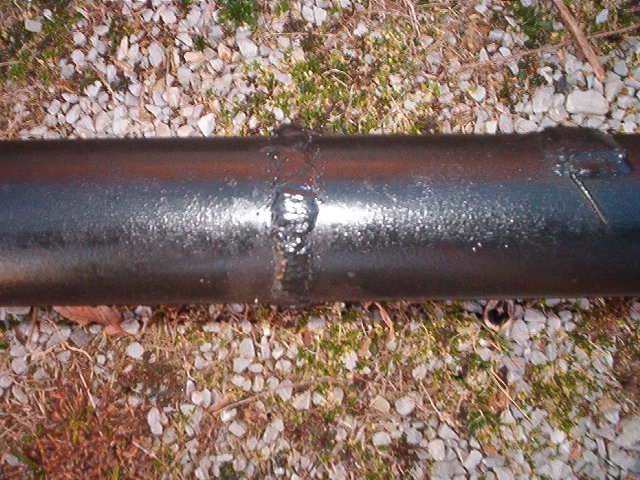

on my caravan and voyager axle, I removed all of the brake componets except for the stud that the springs attach too and used a mig welder and small flat stock 1 inch steel to cover all holes. I didn't want a small rock to get inside the hub and make noise. This should be a picture of how I mounted my axle. Image Here is a picture of the trailer and a picture of how I made the axle shorter.
I hope the pictures work and help. Don :)

Postby purplepickup » Mon Mar 21, 2005 8:14 am
dboyd wrote: Here is a picture of the trailer and a picture of how I made the axle shorter.
http://www.tnttt.com/gallery/image.php?image_id=1104
Is that just a butt weld? If I connect tube I like to insert short piece of tube inside to span the welded area and drill some holes in the outer tube so I can plug weld the inner to the outer tube in some spots. It makes a good strong connection.
...just a suggestion.

Postby dboyd » Mon Mar 21, 2005 10:05 am
I agree with the thought of a inner tube and plug welding it. I left a small gap when I put the axle back together so I could get 100% penetration of the weld. I made sure that I talked to my neighbor (retired welding engineer) and he thought a good butt joint with a gap for penetration would be strong enough. in most cases it is better to add extra than not enough. I thought about taking the section that I cut off and splitting it in half, then I could add it over the other weld. Might be overkill, better safe than sorry! :thinking:
