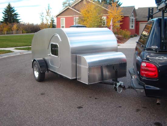

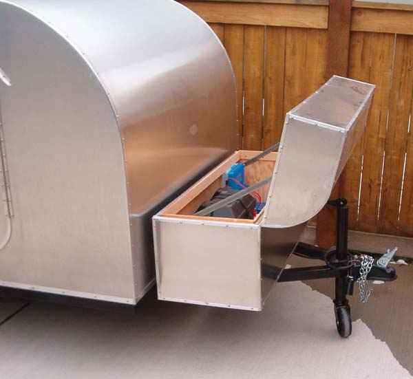

Loader wrote:Looks great. How does it latch closed?
Montana Kev wrote:To seal it there is a 1/2 inch lip that comes up from the bottom half. I sealed the wood with epoxy. Then I used closed cell foam seal tape (from Lowes) around the top of the bottom half. It compresses. I have not mounted the latch but I may use a window latch, the old type that you just rotate to tighten, it fits in a tight space. The weight of the lid holds it down real good and since it hinges from the front it won't blow open. You can also use small compression latches, one on each side.

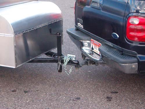

riverfront wrote:Can you jackknif the trailer without damage to the box?
