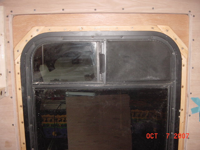

Ron, I am definately not an expert and very much novice. But on the windows it depends on what kind you have and if you have a clamp ring that seperates from the window.
Basically most of the windows I have seen come apart and you build a frame for that to fit. the width thickness of the frame is what ever the depth of the window and frame is. For trailers I think from 1" to 1.5" but depends on the window.
Mine were 2", I built the frame around the inset of the window as you can see here.
Then the clamp ring as I call it is shown in this one. The window is basically clamped to the frame. Some slide windows will have screw holes in the bottom of the framing to screw them in.
Different windows are different install but I think they all folllow that same basic rule.

As you can see my windows and doors were done together. But if you are using the cut out pieces of the doors like I did there are several ways to do it. First the frame is built to fit. If its a cut out then it is pretty tight fit just sand some to losen that and build your fraom around that. The inside interior frame can be done several ways. I used a seal with an aluminum frame.
Initially I was going to use 1" x 3/4" to frame inside but that trim worked so well didnt feel I needed and had a very nice tight fight on the door with no gaps. May need to do that down the road but time will tell.
Hope this helps and maybe someone who can explain it with alot more knowledge then I have will add to this to help you as well.
