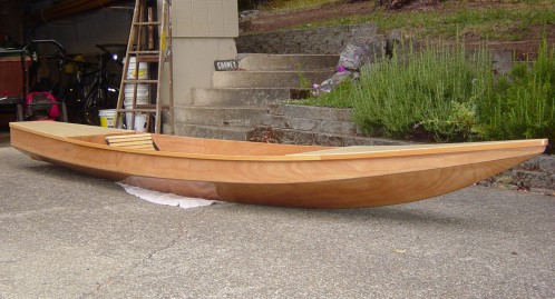

Another option to consider is joining the sheets with a scarf joint. This is regularly used in boat building for making longer sheets. The joint will be stronger than the plywood, so it's a asthetic decision where it goes not structual. I scarfed to two sheets of 1/4" together for making this 13' kayak.
Here is a overview on scarfing plywood, http://www.duckworksmagazine.com/05/articles/scarfs/index.cfm
