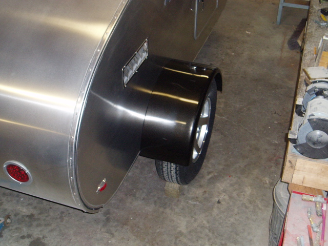

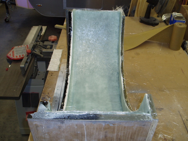

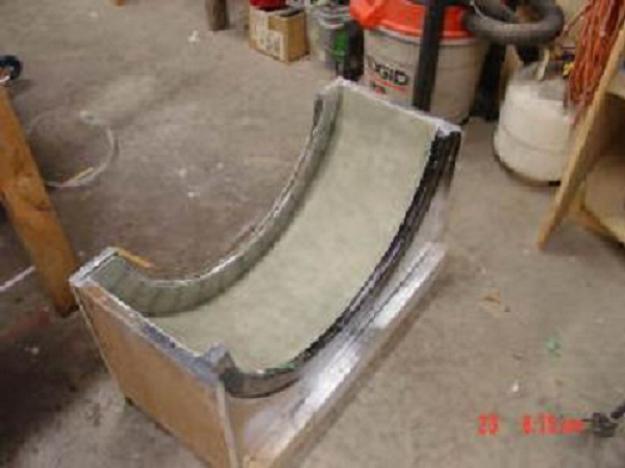

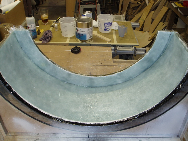

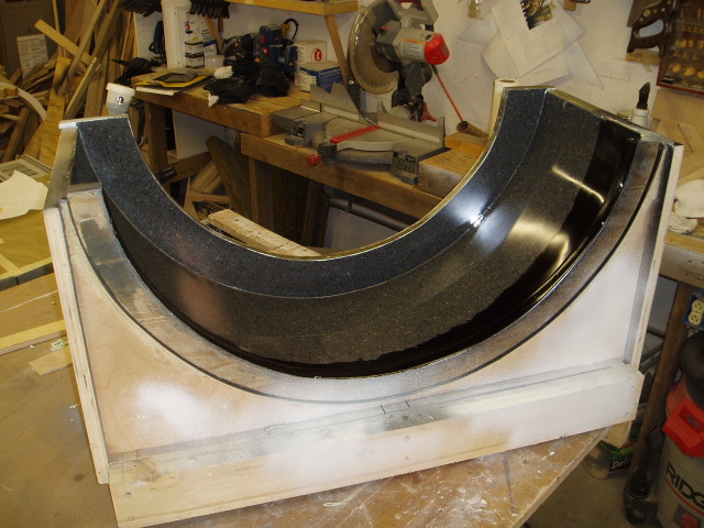

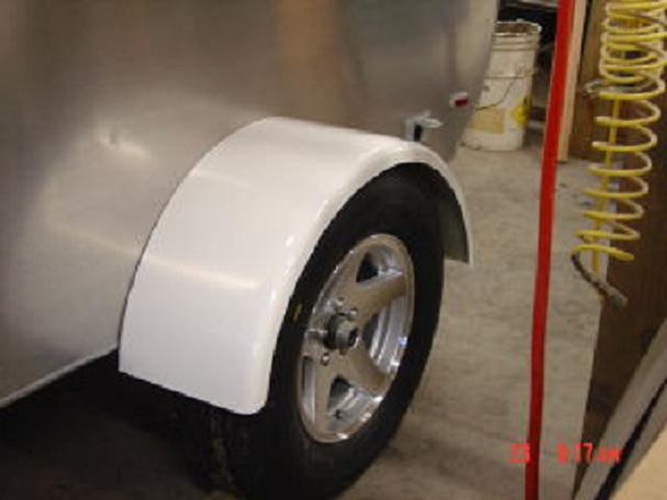

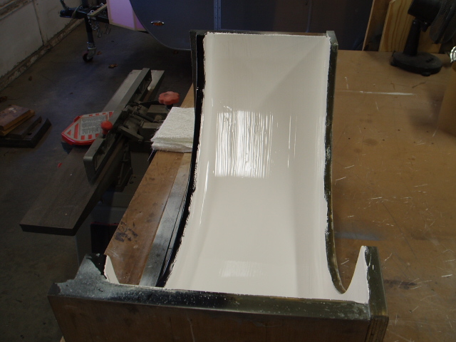

I didn't like the fenders I installed on my TD because they left an opening from the fender to the side of the trailer, so I took one of the fenders and used the out side profile to make the black portion of the Mold, picked up some supply's and made my own fender. The fender that was on the TD was only 8" wide and this fender is 11 1/2"W and has a built in mounting surface on the inside of the fender. Now only one more to make.
Mold with wax and PVA Applyed
Gel-Kote Applyed
First layer of glass installed
Last layer of glass installed

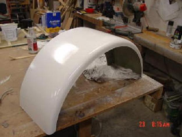

Fender ready to come out of mold

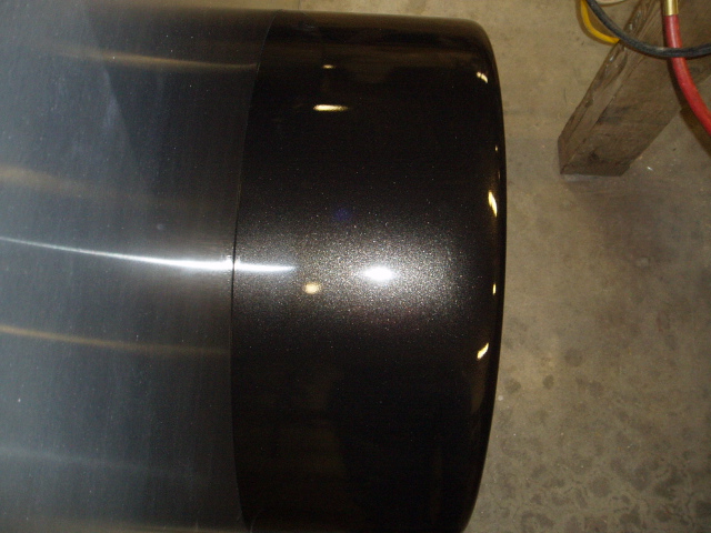

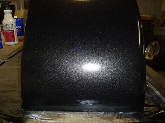

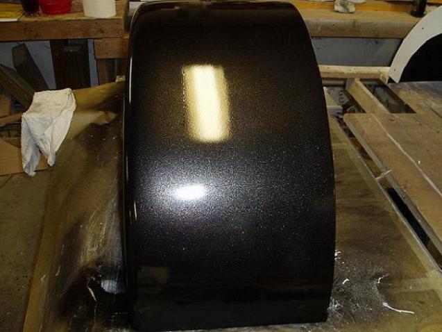

Completed fender

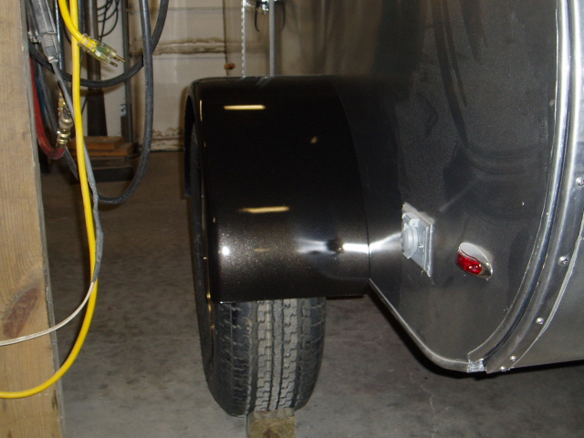

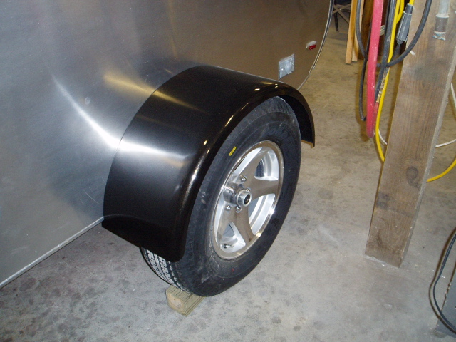

Fender almost ready to install

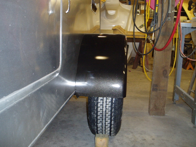

Postby legend lime » Wed Oct 31, 2007 8:49 pm
Here is an up-date on the fenders they are complete and installed I like these a lot better than the ones I install the first time.
