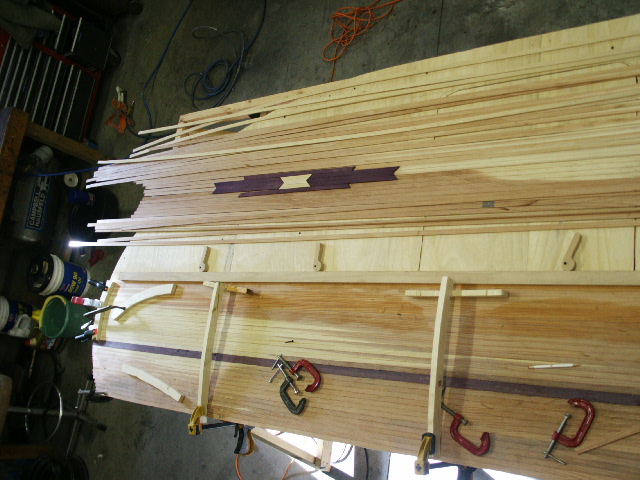

Postby Jst83 » Thu Nov 01, 2007 8:47 pm
So how are you holding the strips on (what glue)
and what will you coat the strips with?

Postby prohandyman » Thu Nov 01, 2007 9:05 pm
Yep, good ole Tite Bond II, very good glue. And then epoxy and glass over all.

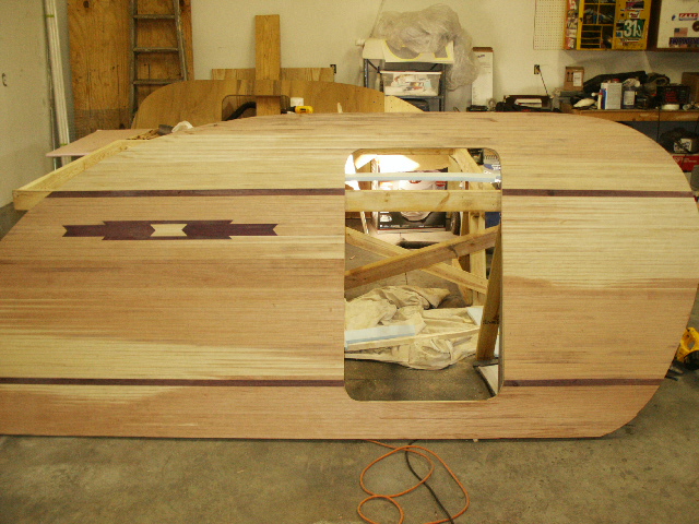

Postby prohandyman » Thu Nov 01, 2007 9:18 pm
My plan is to cut the doors out from the opposite side with my circ saw, which will cut inwards, following the previous skin cuts, so as not to tear the strips. Thats the plan anyway!?!

Postby Juneaudave » Fri Nov 02, 2007 9:31 pm
Those look like the "DannyCams" applying pressure!!!
How are they working and how many strips at one glueup??? Looks great!!!

Postby Nitetimes » Fri Nov 02, 2007 9:34 pm
Most be some seriously strong magnets behind there to hold those c-clamps up like that!! :lol: :lol: 8)

Postby prohandyman » Sat Nov 03, 2007 6:40 am
Dave - thanks for the idea! Iv'e been glueing 6 strips at a time. The ply behind the strips is only 1/4", so I didn't want to put any more pressure on the screws holding the clamps.
Ahh - the miracle of photography!

Postby Jst83 » Sat Nov 03, 2007 7:16 am
OK your just going to explain how those clamps work, Or maybe I'll have to plan a trip to see them in person. Or both

Curb side covered
Postby prohandyman » Sat Nov 03, 2007 4:53 pm
Latest pics from today

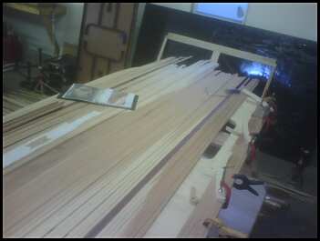

Another view
Postby prohandyman » Sat Nov 03, 2007 4:55 pm
