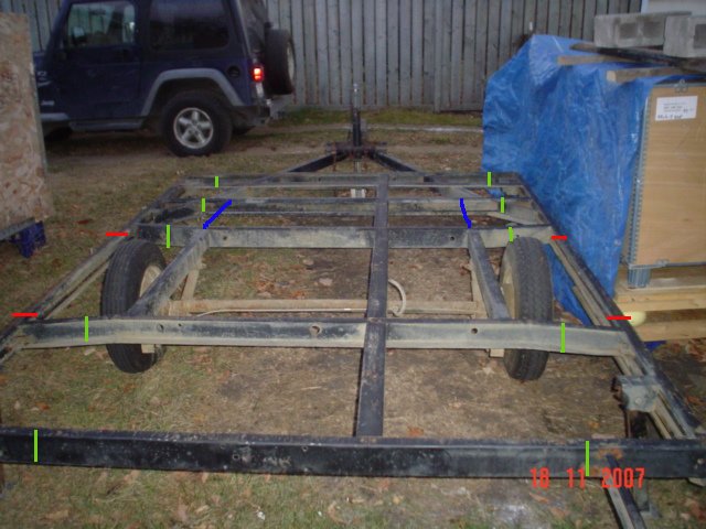

I got my freebie frame revealed after a few days of tearing down the camper rotting on it, now I need some advice on narrowing the frame.
The frame is 78" wide which is too big for my needs, more important I don't want it 18" wider than the Jeep.
I want to reduce the width a fair bit, what I am thinking is I can remove the sections between the red lines to add support where the blue lines are and then bring the remainder of the sides into the green to give it a 5' width.
Am I going to be creating an unsafe frame? The tongue and spring mounting rails are 2x3 boxed the rest is a mix of C channel with and without a lip on each end of the C - I'm not sure the picture shows this well.
Thanks in advance.
Burke

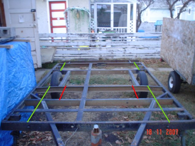

Postby bve » Tue Nov 20, 2007 9:49 am
Thanks Leon, that's essentially what I am suggesting, only without starting completely from scratch :)
I think a view from the front may better help show what I tried to explain above.
I actually want the wheels inset from the edge of the frame such that I build the trailer box around them.
The red is additional support and the green is bringing the existing sides in. I would add the additional support in first to keep things square and together before cutting the cross members.
Again thanks in advance.

Postby angib » Tue Nov 20, 2007 11:00 am
I think the answer is: probably OK.
What you're suggesting will be quite a bit weaker than the original frame because you won't have anything replacing the side rail between the red lines. But then a teardrop doesn't need as much strength as a pop-up camper because its body is largely self-supporting.
Adding the blue (in the first photo) support will strengthen the frame a fair bit but its joint to the spring mount tube won't be that strong as there is the cross-member in between.
If the extra supports go where the red line is in the second photo, they won't work nearly so well as they're not connected to the spring mount tube.

Postby madjack » Tue Nov 20, 2007 11:05 am
Burke, you really don't need the support in the red areas...cut, trim, fit and weld up the rest properly and you should be good to go...the only thing else I would add, is to check the bearings and seals closely....

Postby depatty » Tue Nov 20, 2007 12:39 pm
That looks like a mirror image of the popup frame I built my TTT on. Difference being the floor connection strip/band is on the other side. I'd say go for it, with or without the bit in red in the second posting. Once the teardrop is attached/built on it, it should be quite rigid.

Postby bve » Tue Nov 20, 2007 11:28 pm
Thanks for the replies, you all have pretty much put my mind to rest on something I figured would be OK.
Andrew, I get what you are saying about the red in the 2nd image. I'm not sure why I moved the added supports inward on the 2nd (I'll chalk it up to early morning), my intent was as in the first image to keep them inline with the spring rails.

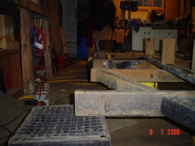

Postby bve » Mon Jul 14, 2008 9:08 am
After putting it off for way too long I finally have finished (mostly) with narrowing the frame.
This shows the side rail cut and inserted to be used to add support - just sitting in for a test fit.

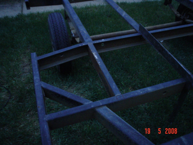

Here I decided to add a gusset (so to speak) too.
Most of the cutting on one side done.
Everything cut and tacked into place. Still need to stitch all the welds up, but the worst is done with.
