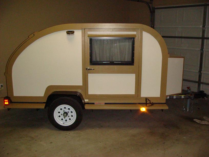

Postby Dooner » Tue Nov 27, 2007 2:15 pm
Here is a cheap option. I just painted mine with house paint.
I'm very happy with the way it turned out.
Dooner.

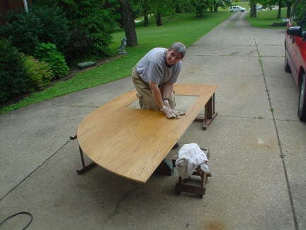

Postby b.bodemer » Wed Nov 28, 2007 1:50 pm
I was origianlly going to keep a wood look for the sides and paint the top but then I saw how cool the wood looked overall.
Oak Sides:
Birch Top:
Finished look:
Have fun deciding...........................

Postby Alfred » Wed Nov 28, 2007 8:27 pm
Dooner wrote:Here is a cheap option. I just painted mine with house paint. I'm very happy with the way it turned out.
Hey! I think that looks great!
I like the KISS approach of just painting it, I mean its good enough for houses year round, ought to work for something that is just going to be outside a few days, once in awhile.
My question is how do you seal it underneath? Did you still epoxy or glass, or primer then paint, or just paint (How many coats???)
Thanks, AL in Asheville :thumbsup:

Postby Dooner » Wed Nov 28, 2007 10:15 pm
To be totally honest with you, I really didn't see any reason to have to go overboard sealing the bottom. I know, I know, there are a lot of you that will disagree with me. And I may regret my decision later, but for now, all I did was spray paint it black. :shock:
I started with a flat black paint. It seemed to soak into the wood. I put on 4 or 5 coats of the flat. Let it set for a week and then used a gloss black. Put on a few coats of that and it seems to me to be sealed as well as it needs to be. After that set for a week or so, I sealed around the frame rails between the metal and painted wood with black NP1 sealant. That was so I wouldn't get dirty or mud in between there and hold moisture.
I will keep an eye on it and if I see something going on, I will take care of it right away.

I meant underneath the paint not underneath the trailer
Postby Alfred » Wed Nov 28, 2007 11:45 pm
Hi Dooner,
I am guilty of semantic ambiguity! I meant, how did you undercoat the paint, on the entire camper, not just underneath the trailer!
Thanks, AL.
Alfred
Posts: 1633
Images: 368
Location: NC, Asheville
Re: I meant underneath the paint not underneath the trailer
Postby Dooner » Thu Nov 29, 2007 1:00 am
Alfred wrote:Hi Dooner,
Thanks, AL.
Gotcha! :? I primed with http://www.zinsser.com/product_detail.asp?ProductID=11. Seemed to be very good. Sealed stains and also smoothed out some of the nicks and imperfections.
I guess, only time will tell.
