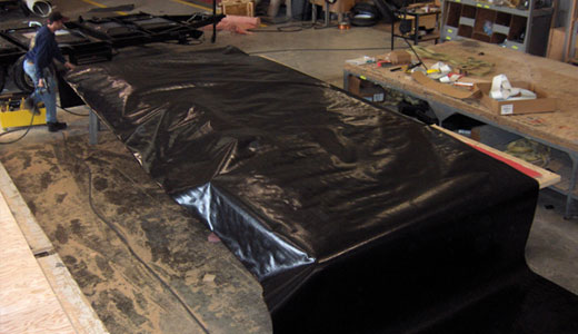

I know the picture doesn't say much but wanted to show as much detail as I could. Besides the thing is 8' wide! Just got it in this afternoon.
Please note: the pic below is not from my actual build. Borrowed it from the net.

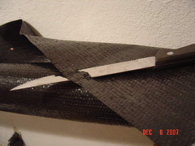

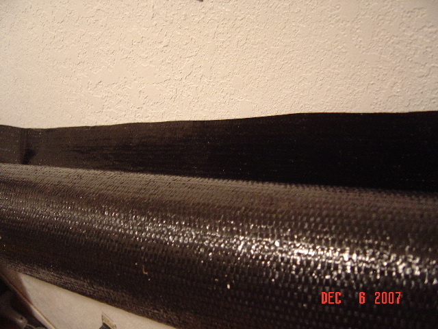

I just did my own "quality-test" on this stuff and this is what I have so far.
1. The knife pierced pretty easily.
2. It will not continue to tear or "unseam" by pulling on it. Looks tough.
3. One side of it looks very similar to a regular blue tarp you can buy anywhere.
4. The other side seems to be smooth, sort of like it is two ply or has been heat pressed.
5. Since I ordered more than I need, I already took a piece off and will do a water test, over a 5 gallon bucket, for awhile. We'll see how it holds.
