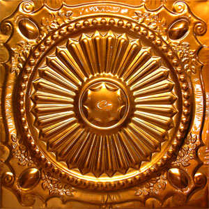

I'm really trying to incorporate a lot of vintage/retro ideas on this build. I thought this might be a different approach to the galley cabinet doors. The punched tin technique was used on pie safes to protect baked goods from dust and bugs, any more it's just decorative. I'll have 3 across the back and 2 smaller ones under the stove storage area. Panel shown measures 12 x 12. Some Jadite green knobs in a mahogany frame I think is going to look pretty good, and Rich....the green knobs match the wheels!!! :lol:

Postby doug hodder » Sat Dec 22, 2007 1:24 pm
Rich...I had them punched for me. After machine turning the cabinet doors on the Rocketear myself, I didn't want to make another career out of cabinet doors. They're not real cheap, but I didn't want to cut a corner on the look I wanted. Co. is in Williamsport Pa. www.piercedtin.com You can buy the blanks and they have a large collection of special shaped tools available if you want to do it yourself. Doug

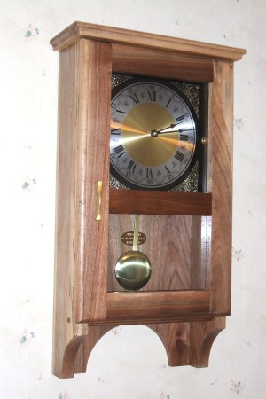

Postby Nitetimes » Sat Dec 22, 2007 1:48 pm
Very nice stuff. I'll have to keep that link handy. Might be nice to do for some of the clocks my dad has been building too...maybe change the height and put a panel between the face and the pendulum??

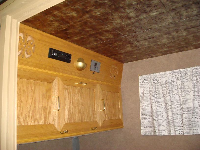

Postby Dooner » Sun Dec 23, 2007 1:34 am
doug hodder wrote:Dan...I thought about the tin ceiling also...thing is, the patterns are so large that it wouldn't look quite right in a tear, at least I didn't think so. Also, depending on the depth of the pattern stamped into them, they won't form to the curves without a kink...I used to have about 1500 sq. ft of it that I scrounged from a restaurant, sold it to an architectural salvage guy. They didn't want to bend at all. Doug
:) Hey Doug, Look close at my ceiling. About four inches of it is curved on the end you can't see in this pic.

Postby doug hodder » Sun Dec 23, 2007 1:45 am
Dooner...is that tin? If so, it laid down as smooth as vinyl. I haven't found a stamped panel as flat as that. If you're holding out on a supplier, please let us know! It looks great!!!! Doug

Postby Dooner » Sun Dec 23, 2007 12:43 pm
doug hodder wrote:Dooner...is that tin? If so, it laid down as smooth as vinyl. I haven't found a stamped panel as flat as that. If you're holding out on a supplier, please let us know! It looks great!!!! Doug
Hey Doug, it's not tin. It is a plastic panel made for backsplashes. I found it at lowes. It is a little pricey, but I wanted that look. Here is a link to it.
http://www.lowes.com/lowes/lkn?action=productDetail&productId=240705-82801-B50-19&lpage=none
I used an adhesive made by Dap. On the curve, I braced it up with a 2x4 with padding on it across the ceiling and held up with some 1x2s. Once it set up, it was there. I'll find out for how long I guess.
