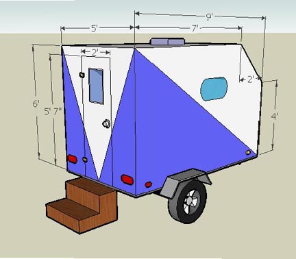

Been working on a new design for our camper. Basically the same shape only bigger, and no side doors. We will be able to stand up in this one.
Now If I can just figure out how to show the insides.

I had thought about a 6' wide but decided to go with 5'. I need to keep the weight down as much as I can. There will be two 6' beds on each side with a space between them. I'll be able to cover that opening if I want one big bed. There's enough room at the ends of the beds to put a A/C on one side and a porta potty on the other. On the A/C side I'll install a shelf above it where I can cook on it with my electric griddle.
I'm trying to build a self contained camper so if the weather is bad we can just stay inside. I hate getting dressed out side in the cold. I'm doing another drawing with SketchUp showing the insides. I'll post it when I get it finished.

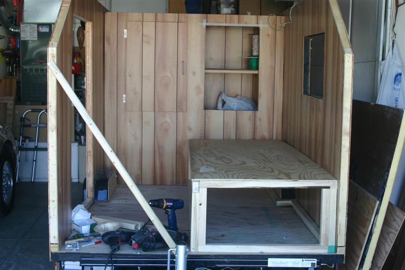

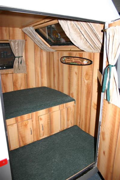

SmokeyBob I'd check out your bed size before I get much farther. I built a single bed/couch in my trailer that is 5'wide. The bed is 30" wide and I'd really like it 2-3" wider. Minimum size I'd say you could use at all is about 27" wide (if you're small) and with two of those in a 5' wide trailer that leaves a 6" aisle not accounting for any wall thickness.
I think I would build 6' wide over the axles to gain the extra space. Even in mine I now wish I'd gone a bit wider and completly covered the fender for the extra room inside.
Here is finished interior:
And here is during construction, you can see how little floor space is left with a 30" bed in a 5' trailer

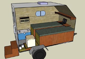

Here is what the inside might look like. The space between the beds will be filled in with a center board at night giving us about a 5' x 6' sleeping space. The lower shelf at the head of the bed would fold up against the wall when not in use. Thanks for the thoughts on going 6' wide. I could still go that way. I won't start on this till it gets warmer and if I have the money saved up.
I'll put in a shelf just above the cooler for cooking on with my electric grill. The cooler will be on sliders to gain access to it. And I'll probably move the A/C a little higher and it will be on sliders also.
And in case anyone wants to know, that's Charmin Extra Soft next to the Porta Potty. ;)
