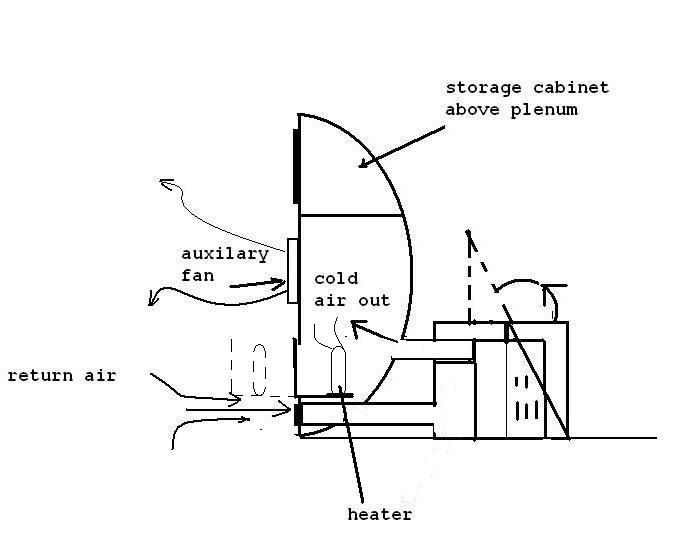

I am kinda tired of juggeling little heaters hung here or there or bouncing out of a cabinet. The thought of toteing a AC unit here and there and routing hoses is also a pain.
My little 4x7 left little if anywhere for either so I played with a tongue mounted 5000 btu AC unit that would be permanently vented to the body and a small heater mounted in the plenum made of of a few inches of the rounded nose.
I have also thought of simple fan powered balance tubes that would draw the heated air off of the top and vent it outside in warm weather or back in the trailer in a low almost floor register like tube in cold weather to break up the stratification that occures at the roof.
