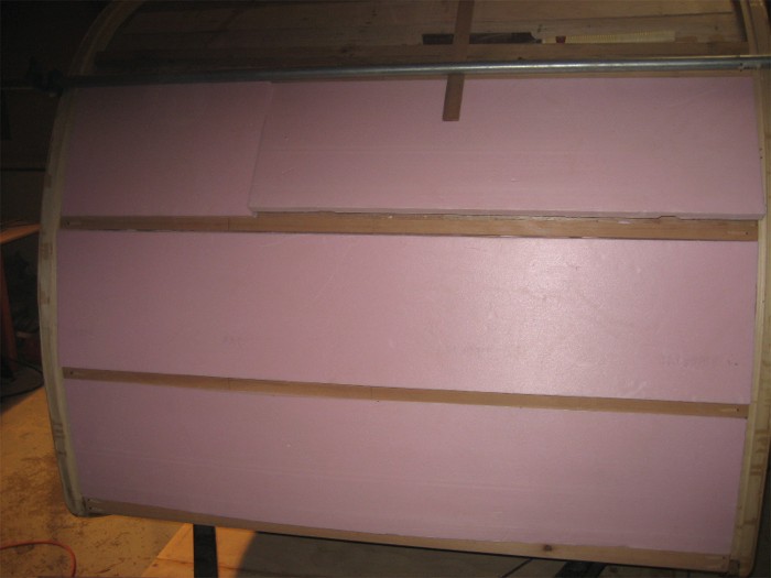

Got a wild hair tonight and started putting in spars...true 1 inch x 1 inch spars with 1 inch pink Foamular (12 inch centers)... the insulation so far is really tight, but I have to press pretty hard to bend it around around the curve...
Do most people scarf the insulation? Or will the strap clamps (when I get some) pull it tight enough I won't have to scarf? Oh yeah...geez...a fella is in Alaska and only using 1 inch insulation...go figure...

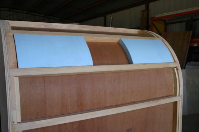

Postby tonyj » Wed Feb 13, 2008 10:03 am
I had to kerf the insulation on the curved sections because it was 1-1/2 inches thick and wouldn't bend. The picture shows a test piece, the actual had half as many kerfs in it.

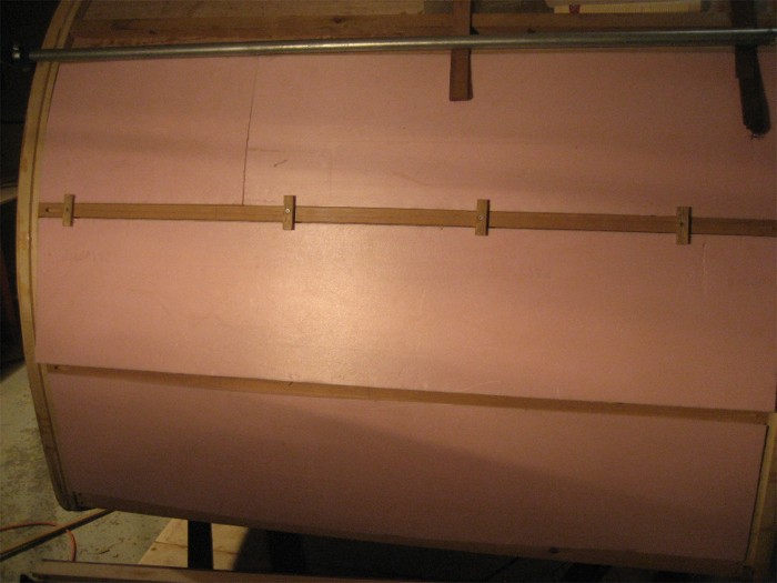

Postby Steve Frederick » Wed Feb 13, 2008 9:36 pm
I did two layers@ 3/4" each.
I kerfed the backs..
Spring clamps and scrap wood hold the first layer..
To hold the second layer, use scraps of 1/4" ply, screwed to the roof spars..

That seems to be doing the trick...a few scarf cuts and temporary scrap pieces screwed into the spars. Much easier to work with. I've been wondering if that 1 inch foam would bend without scarfing.
