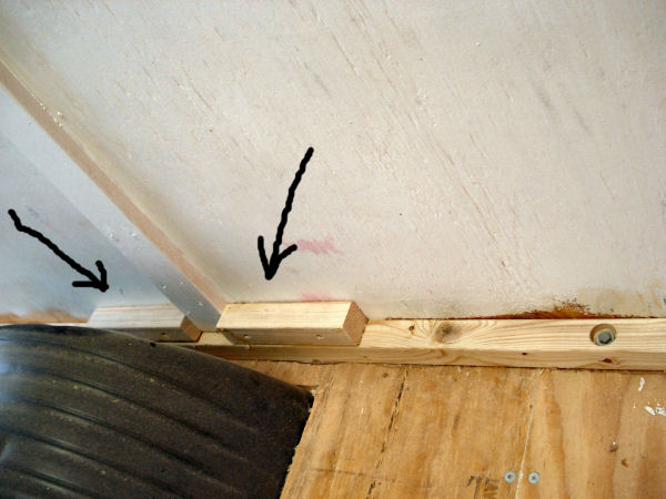

The little 2x2 (or whatever that is) on your floor is what I had screwed to the sides of my camper. I then hoisted my sides on the camper and that little 2x2 supported the walls until I could screw a 2x4 into the sides to keep it from laying over. I actually managed to do it by myself, but it was a bit nerve racking.
You probably could screw a few 2x2's to the bottom of the sides to act as a lip for the wall to sit on the trailer with. Then you can remove them after everything gets tied together.

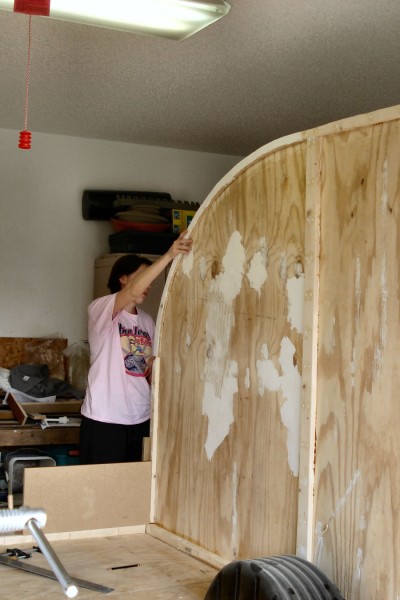

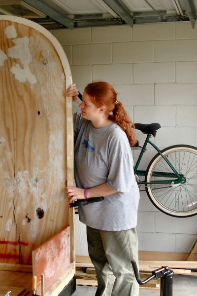

Thank you everyone for all of your great suggestions. I'm pleased to say that my walls are now attached. I was very worried about doing this but once I read that there were women that did it alone, it gave to the courage to go for it.
I used Amy's idea for the clamped on braces
And Steve's idea for the 2X2 shelf/lip

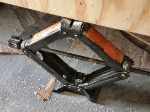

Two car jacks
And two friends to keep the walls from falling off of the jacks
