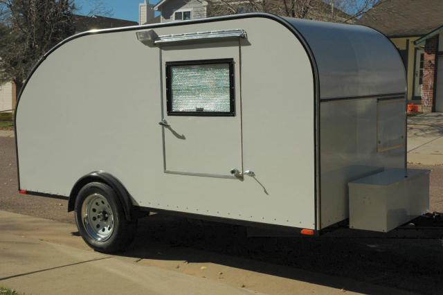

I seamed my Filon to my FRP (FIberglass Reinforced Plywood) about 30" up on the front. My Filon is glued down and overlaps the FRP by about 1 inch. I then added a RV trim strip, with more sealer, over the seam. Sorry, not the best picture.
