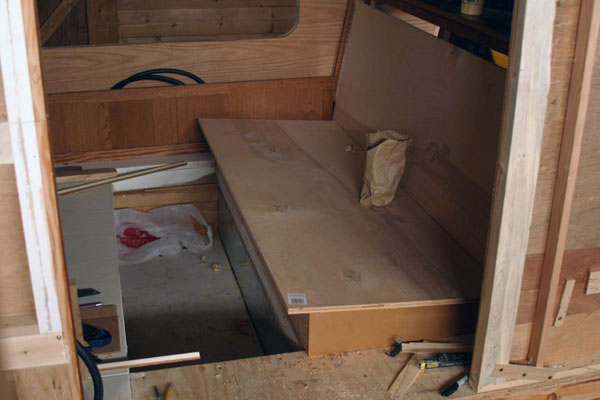

Postby jdarkoregon » Thu Feb 21, 2008 1:03 am
9 inches with extra toe space under the bed

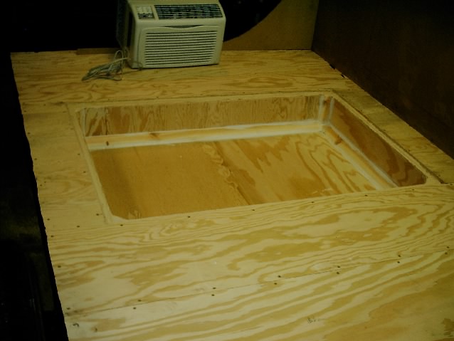

Postby Donutboy » Thu Feb 21, 2008 9:07 pm
Mine is 9 1/4" deep, with 7" of clearance between it and the ground. Only time will tell if that's enough clearance to avoid scraping things.
