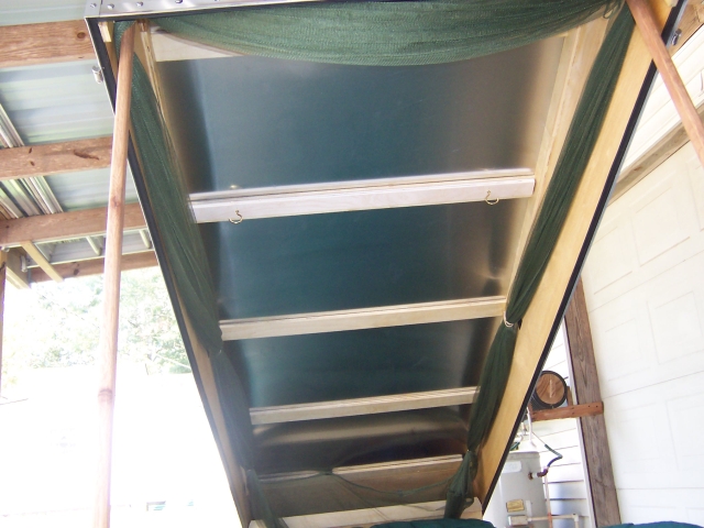

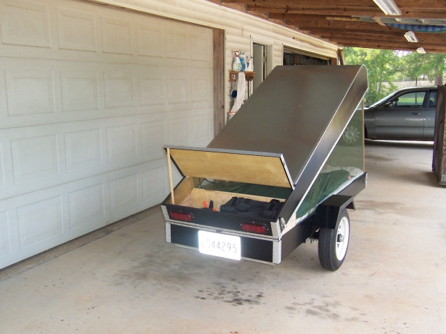

Postby madjack » Thu Feb 21, 2008 11:28 pm
...anything similar to this....
http://s199.photobucket.com/albums/aa60 ... 5/bedroll/
...this was built by my partner, it is 30"s wide and 7' long...it is about 16'" tall at the front and opens up in a clam shell manner...to get it to tow properly, he moved the axle back about 6"'s and lowered the hitch height...
http://s199.photobucket.com/albums/aa60 ... n%20hitch/
..you might wanna drop "B52" a PM or email about it......
http://tnttt.com/profil ... file&u=553
madjack 8)
p.s. he tows with a Harley NightTrain...but he would probably still talk to ya... ;) ...................MJ

Postby madjack » Fri Feb 22, 2008 12:26 am
...ej, since those photos were taken he has done a lot of work on the unit...he has a drop down mosquito screen and has built a pretty nice side tent and enclosures to weathproof it...give him (Jim/B52) a shout, he probably has more pics of it as it is now.......
madjack 8)
p.s. he started with the same HF trailer as you, tossed the steel and used aluminum "hat" channel for the frame(think hiway signpost shape)...the whole unit, wheels, axle and all only weighs in around 200#s with about a 20# tongue weight.......MJ

Postby elderjay » Fri Feb 22, 2008 5:51 pm
Great pic's Madjack. That's exactly how I planned to attach the canvas around the inside of the lid only use 4 poles and have a flat wood roof that rises vertically. My bike is heavy enough that I don't need the tripod attachment to sleep in it connected. I'd just lock the trans in reverse and nobody can roll it. The Rivco hitch I use keeps me perfectly level right now with the 12" wheels. Think I'll just build it and then decide if I have to add additional tongue length.
His tongue is too short for me. I'd hit my hard saddlebags if I wasn't careful backing up. Sweet job though. The boss keeps telling me I don't have time to go camping (preachers are always busy on weekends) but it would be a great cargo/sleeper and I do enough electrical and handyman work around our congregation to make it worthwhile.
