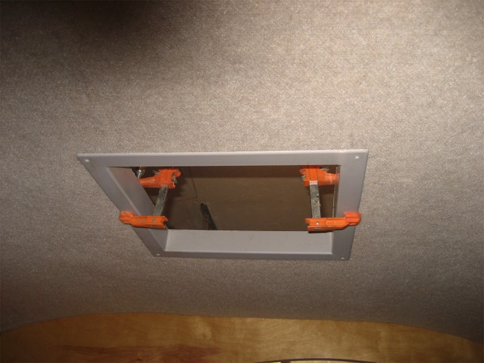

I didn't like the one that came with my vent so I made my own.

Postby Juneaudave » Sun Feb 24, 2008 8:23 pm
Sonetpro wrote:I didn't like the one that came with my vent so I made my own.
Veeery nice...humm... :thinking: :thinking:

Postby Sonetpro » Sun Feb 24, 2008 9:36 pm
I just used some oak corner moulding and framed it up using a picture frame strap clamp.
The wires are for my home made computer fan vent fan.
