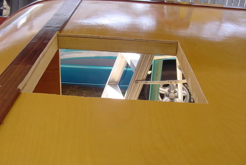

The hole cut out. As you can see the trim is an issue.

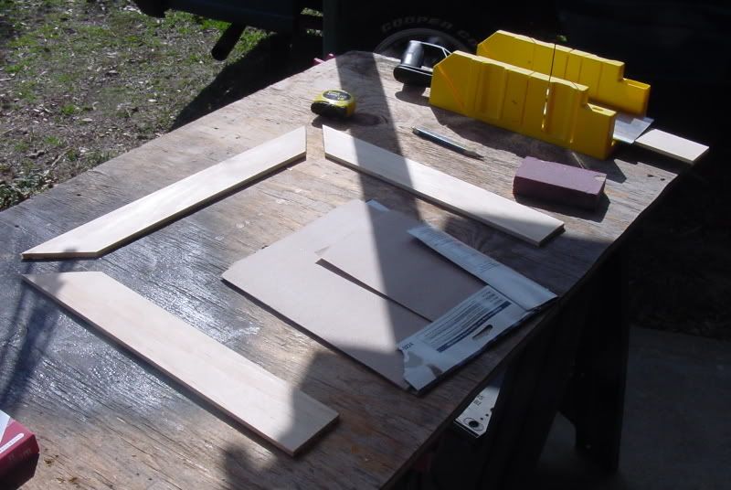

So, I added trim around the hole to have the fan sit on a level surface. I decided this would be easier that trying to remove the cross trim already on the TD.
Glued, screwed and clamped down.

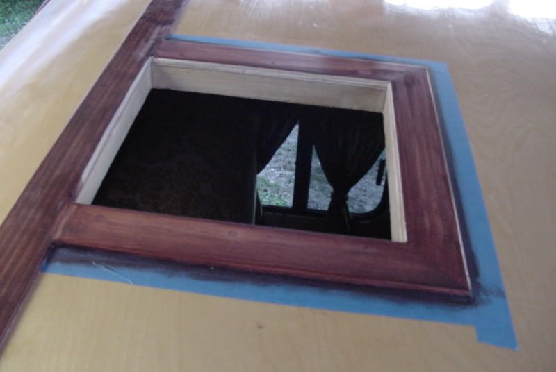

Stain and 1 coat of urethane on.

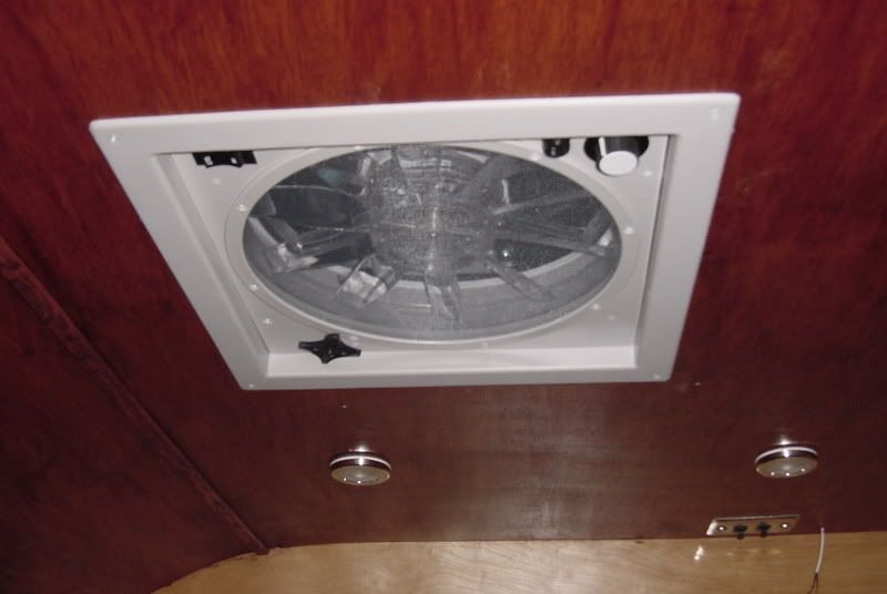

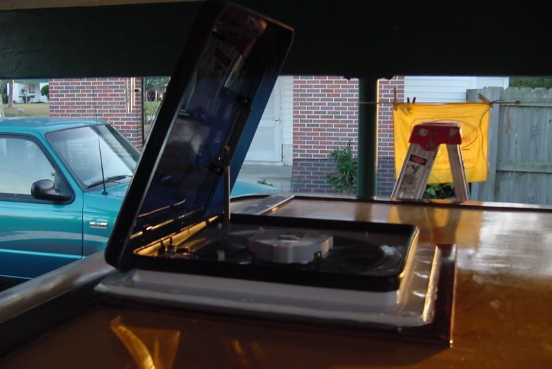

After 2 more coats of urethane I installed the fan using the foam gasket piece that comes with the Fan. I caulked around the edge and screws holes.
Interior view.
Now, all that is left to do is pray it does not leak. :lol:
Seriously folks this is a Fantastic Fan... I mean it really is a GREAT fan , and well worth the price. :thumbsup:
