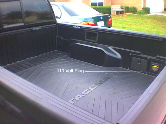

What's your entire wiring schematic look like? I'm wondering about what to do with mine since I can use the plug in the back of my truckbed if I need power. Here's a picture. Trouble with that is I have to have the truck running I think, I haven't used it yet.
