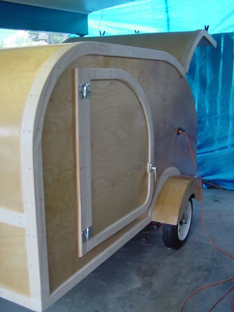

I gotta ask how one makes the wood trim follow the trailers curves? Is it so thin it bends? I can see that working on the top of the roof skin, but I can't picture how it is done on the wall exteriors.

shoeman wrote:I gotta ask how one makes the wood trim follow the trailers curves? Is it so thin it bends? I can see that working on the top of the roof skin, but I can't picture how it is done on the wall exteriors.
Geoff
I used a 1x12 and cut the curves from it.

Postby Steve_Cox » Wed Mar 12, 2008 7:30 am
Hi Geoff,
Several ways to do this, I thought this way was easiest.
My trim is a lamination of several layers about .200 of an inch thick, the top one was 1.5 inches wide, with half of it hanging over the side edge of the TD. It was epoxied and screwed on first. Each subsequent strip was .750 inches wide by .200 thick and epoxied under the top overhanging piece, etc, etc, until the desired width was achieved. Belt sanded smooth on the edges and rounded with a 1/2" radius router bit.

Postby Juneaudave » Wed Mar 12, 2008 8:32 am
I made my trim with a router, the inside curve is the first cut using a router with a guide before the roundover .

Postby shoeman » Wed Mar 12, 2008 12:11 pm
I see. So it can be done with long strip laminate construction bent around the curves, or pieced out of various cuts of board butted together. Steve, did you do the layup right on the tear or while the walls were still off the rig?

Postby Steve_Cox » Wed Mar 12, 2008 9:03 pm
shoeman wrote:I see. So it can be done with long strip laminate construction bent around the curves, or pieced out of various cuts of board butted together. Steve, did you do the layup right on the tear or while the walls were still off the rig?
It was on the tear. I don't near the skills JuneauDave has or Mary Kay, he is a craftsman and she is an artist. I am more a wood butcher. :lol:
