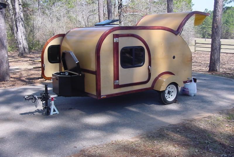

Postby Mary K » Wed Mar 19, 2008 5:21 pm
Yup! :thumbsup:
I used Bullet Hinges from Austin Hardware.
The Doors lift right off. And I have not had one fall off....yet.... :lol: Just kidding. they are not coming off unless they are open and I am lifting them off.

Postby Sonetpro » Wed Mar 19, 2008 5:35 pm
Mary K wrote:Yup! :thumbsup:
I have the same ones. They are as secure as any hinge.
