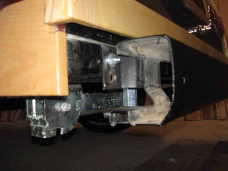

I pull my Teardrop with a Jeep Wrangler. I upgraded to a larger swingout bumper/tire carrier. So I took my old rear bumper off the Jeep and modified the plastic ends (using my bandsaw) and it bolts up real nice to my frame. I used 2" square tubing for the frame. These bumpers are on Ebay all the time for cheap. Looks good and I recycled something. I still have to paint the plastic ends, but you get the idea.

Thanks for the replies , I hope some of you can use it. My Tear 58" wide. The bumper is about 62" or so. My Tear is not here so I can't go measure it. But the Jeep tub is 60" wide. All I did was grind off the weld on the 4 bolts that attached the bumper to the Rear cross member on the Jeep. I also ground off 1 tab. Then I drilled through the 2" square tube on my frame and bolted it through. That was probobly strong enough by it self. But there was a second flange under the bumper that fit right in the center of the frame under the Tear. Since the floor was sitting on the frame I could not bolt through so I tapped the frame and used a hanger bolt (2") as a spacer. It is shown in the blurry picture.

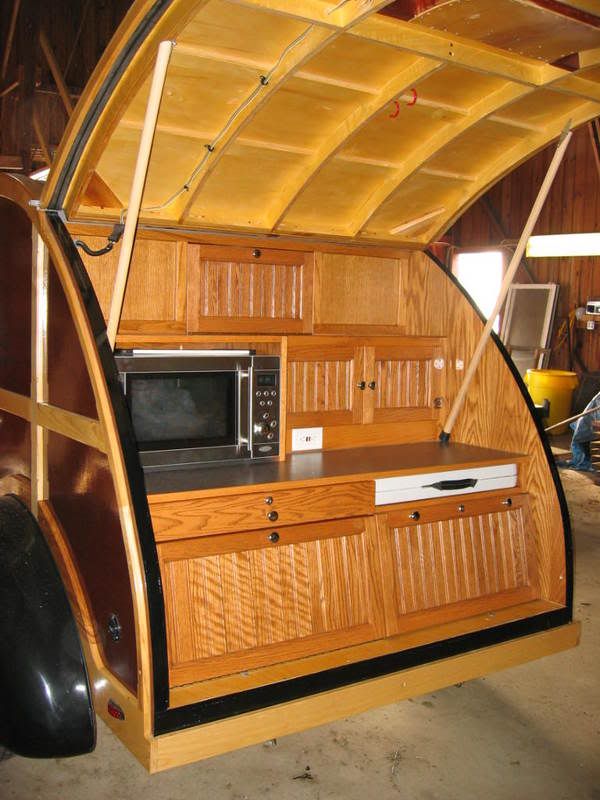

Danny..That is the same trailer as in my album. I will update my album soon. Here are a couple of the more recent pics.
Galley not finished but close.
