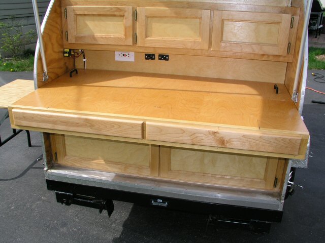

I had to go to a speciality wood store to buy birch hardwood to match the birch plywood. What I found out there is that birch hardwood is wild and wooly. It moves all over the place. It bends and warps and crooks and crows, and you name it, it does it. But I bought it anyway, and the galley I build with birch plywood and birch hardwood looked great. I would do that again...
Here's what my birch galley looked like...

Is that a "set in place" extended counter top on the Baha?
(I see what looks like two black handles towards the back)
How do you stow it?

BTW -- I love the exended work surface in your galley. What do you with it before closing the galley hatch? Fold it down, slide it in? Enquiring minds want to know!

Ah the galley of my first tiny Benroy... it really ended up looking very nice with all the birch...
The extended piece you see in the back with the black handles would go into the Benroy cabin for the trip.
I found that the birch, for the short pieces that I used on the 4' teardrop were well under control. I wouldn't want to make an 8' bookcase with Birch though!!!
In that photo some of the birch is a year old and had already developed a patina, while some of the newer birch, still looked raw. I sure wish I could see it now... A couple in NY has it...
If you are thinking about building in maple get a piece of scrap maple and a piece of scrap birch plywood. You'll find when you do some test staining and polyurethaning, that depending on the color you want, maple is not always the best choice. Maple ends up being too light, and birch ends up being too yellow. So test before you build...
