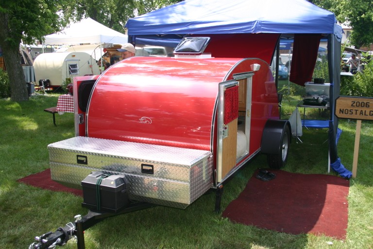

Postby TLC » Thu May 01, 2008 7:13 am
Danny:
I don't know this guys name but he was parked a couple spaces down from me at the ITG last year. He glued his aluminum skin at the joints and was very happy with the results. Maybe someone on the forum can steer you to him.
