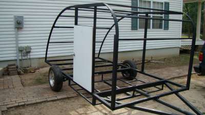

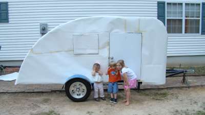

I've been around construction all my life too, but those curves where messing with my head too. So whats a do it yourself hands on guy to do? Well first thing I do is look at whats avaible and handy and at the right price. I did'nt want anything too small either. I brought an axle and some 2x2 14 ga. tubing. Welded up my frame. Found some used 14" aluminuim rims for $20.00, at a junk sale brought a new 2" coupler for $5, at anoughter sale brought a new light kit for $8. I had a pile of old
scrap metal. Used a couple of pieces of the main ring of a trampaline frame for the back curves as they where just right. The front curves where made from an old satelite dish mount ring, sliced in sections it was just right. I then found an old refrigerator door at the appliance repair shop for $2. Took the handle off and put a house doorknob on. Made a frame for the door with some old bed rail angle iron. I hope to get some plywood on it this weekend and get the floor in. You can see some pics in my album. Message me if you have any questions and I'll be glad to help.
William Image 6'4" wide 12' long and 5' high with 9" dropped floor.Image Paper mock up for window size and style.

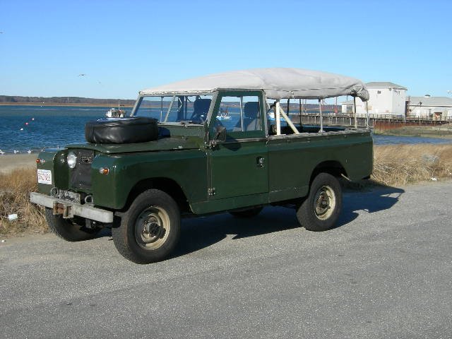

Well, seeing as you asked... :)
This is Mr. Churchill - my traveling companion since the early 1990s. He's a 1964 Series IIA 3-door Rover, was originally a pickup but I went to the full canvas a few years ago for aesthetic reasons (and anywhay, who doesn't love a ragtop?).
Picture, if you will, a Powder Puff done in matching green and sand being towed by this old boy... :twisted:
This old beast and I have many hundreds of thousands of miles under our belts - and two rebuilds, one in 1994 and one in the 2002-2004 range that saw a complete rebuild of the bulkhead and a chassis replacement with a military Series III chassis.
This is why I'm not hesitant at all about my abilities to build a camping trailer... :)
