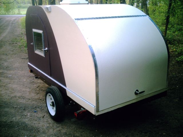

Postby MrBuzz » Fri May 09, 2008 2:30 pm
I found screws very similar to that at my local home improvement store in 2 puond boxes in the same area as the drywall screws & general purpose / deck screws.
I think they were called "pan head" screws...the ones I bought werer phillips heads. I used them specifically for attaching the aluminum on my galley hatch and for the roof vent. In both cases I needed a flat surface and could not use a counter-sink type of screw.
You can kind of get the idea fromt this photo...
