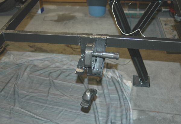

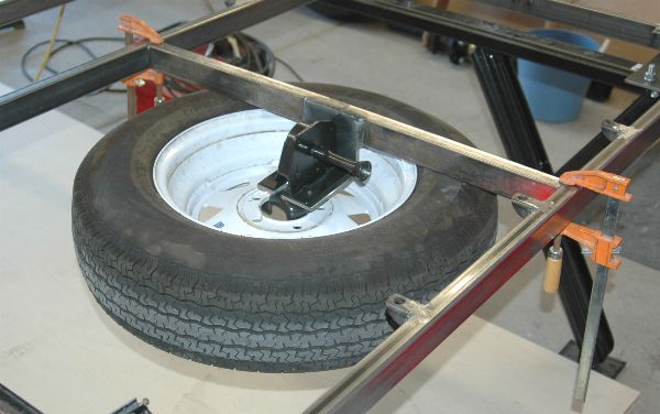

John ,if you were dutifully reading the Desert Dawg website you'd know that my friend Kelly is doing exactly that! :lol: ;)
I think it's going to work great!

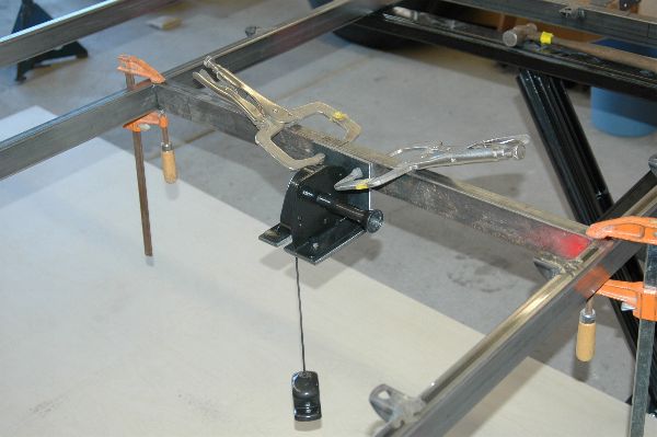

Postby Steve F » Wed May 28, 2008 10:45 pm
I'm using one :) I have mounted it so that it bolts through the floor and into a piece of steel angle (running the full width of the frame) which is bolted to the main frame (after going through the floor again) and is also screwed to the rear bulkhead between galley and cabin. Basically I hung it under the most supported part of the floor and added some steel angle to spread the load.
I also added two full width wooden beams under the floor (one either side of the little winch) for the tyre to tighten up against.
My tyre is also a 31" Mud tyre so weighs quite a bit as well.
