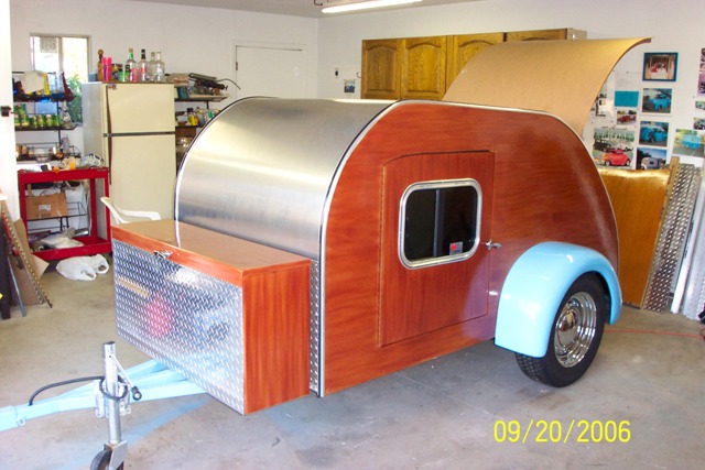

Postby emiller » Tue Jun 17, 2008 9:57 am
Hey Cliff you can do like Bud and do a fiberglass sides then he had them airbrushed like wood. You can see his teardrop in my photo link in my web site http://azroundup.net/photos/2008_fun_run/index.html
Eddie
emiller
Posts: 3421
Images: 157
Location: Arizona, Phoenix
Postby emiller » Tue Jun 17, 2008 10:02 am
Here is a better picture before installing the trim.
emiller
Posts: 3421
Images: 157

Postby cuyeda » Tue Jun 17, 2008 11:35 am
emiller wrote:Hey Cliff you can do like Bud and do a fiberglass sides then he had them airbrushed like wood. You can see his teardrop in my photo link in my web site http://azroundup.net/photos/2008_fun_run/index.html
Eddie
Eddie, Looks like someone is already driving their new toy around!
Wow! nice airbrush technique! One of the reasons, why I may consider a woodie build is that the materials are all readily available. I guess I won't know until I am in the middle of the build which way to go. Depending on the measurements, and available skin material available will determine what will eventually be used.
Hmm... Fiberlass sides... can present all kinds of graphic color schemes!
Cliff & Vanessa
cuyeda
Posts: 1924
Postby emiller » Tue Jun 17, 2008 2:28 pm
Yes Cliff I have been driving the ol streetrod around. I already have over 4000 miles on it since November. The Airbrush artist said it would have come out better with a different base coat. Bud painted it before checking with the painter.
