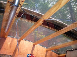

my lexan roof is 3 pieces ice dam tape is your best friendImage
