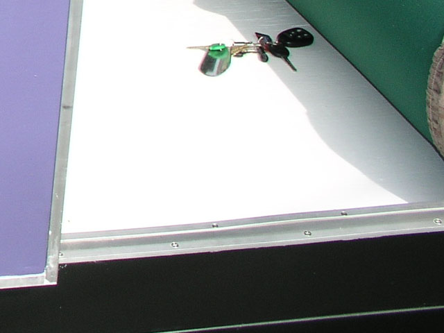

Postby mikeschn » Wed Jul 02, 2008 5:15 pm
The weather stripping should go right there where the thumb is in this picture.
And the drip rail, I just bent it gently by hand.

Postby mikeschn » Wed Jul 02, 2008 5:25 pm
I don't remember the details, but here is a better picture. I got the weatherstripping from Home Depot.
Also, normally the weatherstripping would only go on the door, not on the body like I have shown in this picture.

Postby planovet » Wed Jul 02, 2008 5:46 pm
mikeschn wrote:The weather stripping should go right there where the thumb is in this picture.
Mike, what did you trim the door opening with in this picture??

Postby mikeschn » Wed Jul 02, 2008 6:32 pm
I trimmed it with angle on each edge, with a piece of alum. underneath. The angle had one leg ripped down to about 1/8". I don't know if I took a close up picture of it, and I can't check today, since I left my data drive at work. :cry:
edit: I restored this picture from backup. It shows the trimwork a little better. And oh yea, it's all caulked up too!
