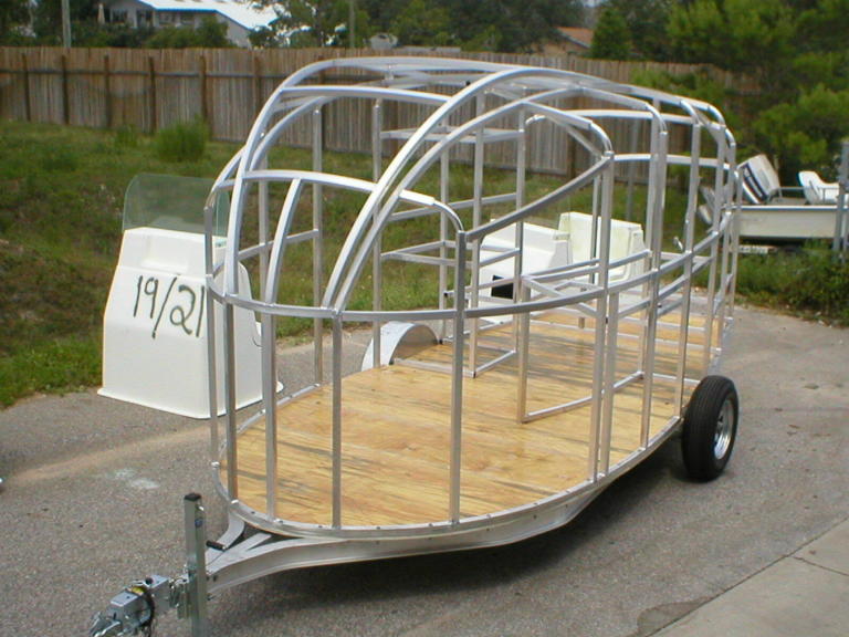

I would like to know what type of tools are used to fabricate aluminum square tube bends like this:
Is there something that I can buy at HF to do the job? Just trying to get an idea of what it would cost to tool up for something like this. I realize there are industrial size tools to do this, but what could a DIY use that would be cost effective? I have no idea yet. Any metal fabrication tradesman out there?

For the large gentile curves, make a "bucK".... Take sheet of plywood, line out curve and screw down wood blocks along line and gently coerce tubing to follow lines by using pressure and gent taping with wood blocks and hammer....
For sharper bends either conduit bender of may be harbor freight bender will do.... Not big monster bender but the lighter bender for ornamental iron work...

As Dale mentioned, for thinner aluminum tubing you are not going to need much force for gentler curves. For longer, sweeping curves you'll probably end up with a better result if you do make your own form.
For tight corners, something simple like this hand operated unit is probably best. A conduit bender would work, but most are only for round tube/pipe and are only moderately accurate at best (your eyes are just too far away from the bend angle markers when standing and pulling on the handle).
http://www.harborfreight.com/cpi/ctaf/displayitem.taf?Itemnumber=3755
Shop around. I can't find anything online, but I swear I have seen units like this come in kits with different size and radius dies for both square and round tube for $100 or less. Hand units like these will be capable of bending mild steel, so aluminum would be no problem.
You can get a unit from harbor freight with a 16 ton ram jack...but unless you want to fold your trailer in half, that's a bit overkill. :D

If you look closely on that trailer, any tight curves are round tubing connected to the square tubing. So the tight bends could be done with something like a conduit bender, and the others by bending them on a buck.

I would guess the square/rectangular tubing was bent with a roll bender that utilizes three shaped rollers. The real deal, a powered one, is probably not affordable to anyone unless he has a fabrication shop to make money off of it. I had a local wrought iron fabrication shop trial roll a curve in 1" square 16 gage aluminum tubing but the rollers were not set up correctly, it put a nice curve in the tube but deformed it in cross section and made it a bit of a parallelogram. This was the right concept, just the wrong set up of the equipment. You needed to be there to meet the guys that gave it a try...the shop owner wasn't around and probably could have done it correctly. Their machine was similar to this one, but electric powered:
http://bii1.com/specs/ringroll/bii-m10.htm
The forum member who made that aluminum framework probably had access to a machine like that.
