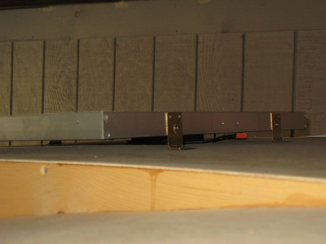

My mount is a fixed mount. It doesn't allow for movement to maximize exposure to the sun. I just used 4 hinges to attach it to the top. I'll try to get a better picture this evening.
Here in this picture I had to remove the screws from 2 of the hinges to let Chell work on the electrical.

Postby mikeschn » Thu Jul 17, 2008 6:22 pm
Okay, here's another picture of how I mounted it... of course, I am probably going to replace the brass with aluminum to get around the chemical reaction between the two dissimilar metals.
