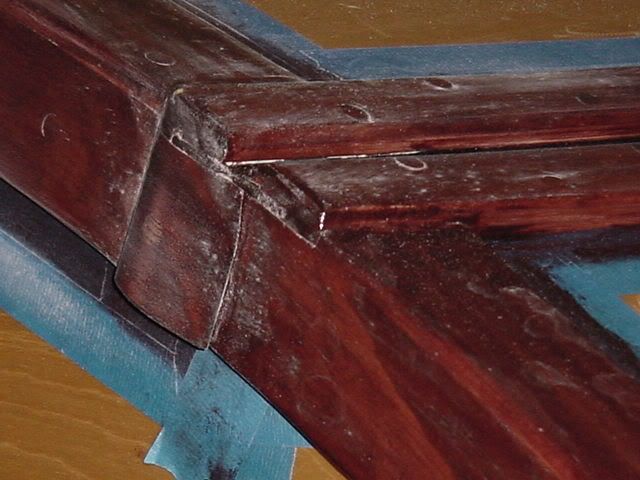

Postby Mary K » Thu Jul 24, 2008 4:30 pm
I am not to sure exactly how you are installing your hatch, but here is how I did it.
Before trimming back.
Then I added a Rain Diverter
Then I sanded it back.
After one coat of Spar and a sanding
The diverter is fixed on the side trim and the hatch trim slides under it to.. well... divert the rain.

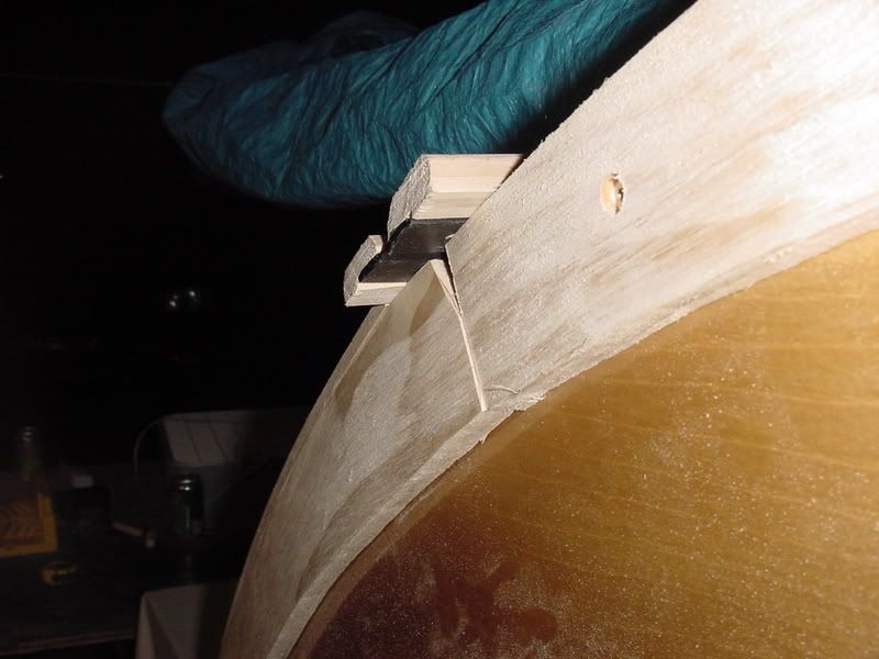

Postby madjack » Thu Jul 24, 2008 7:36 pm
Shoe, I can't findda pic BUT we trimmed the hatch side of the HH...the down leg interfered with the top of the side wall and we trimmed about half the width and in to the outside hatch rib/spar(about 1=3/4 r 2"s)
madjack 8)

Postby shoeman » Fri Jul 25, 2008 6:34 am
Exactly! :thumbsup: No way would the hatch close with the hinge as delivered. It's just as you described, Madjack. Not a big deal to fix at all, and I expect Grant knows it must be done. I'd have called him to ask but the East Coast to Left Coast time difference has made that difficult this week.
