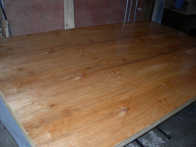

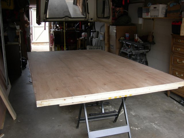

Postby EPGregg » Sun Jul 27, 2008 6:02 pm
Kdog. here's a before and after the CPES Sealcoat. I just did it about an hour ago.
Jack and Mike, thanks for the confirmation and all the Help!!

Postby mikeschn » Sun Jul 27, 2008 6:15 pm
Awsome looking... can't wait till mine looks like that!!! :D
You did that in the garage? You must be feeling pretty high right now! :o
