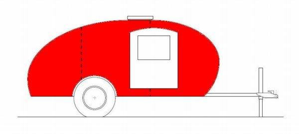

I have vacillated between paint and other materials for my outside skin for a while now. Currently, I'm leaning toward aluminum due to looks and durability (I’m not a good painter). Prices around here for sheet aluminum aren't too bad. The problem is that my tear is going to be a difficult length (and height) to skin with aluminum. The sides are 4'9" high and 11' long at its longest point. Initially I was wanting to do red sides with a white top. Turns out, the only painted aluminum I can get locally in red is 4x8 and 4x10. I can only get white in 5x10.
If I do the sides in 4x red, I will have two seams...one through the door area and one around the galley hinge area.

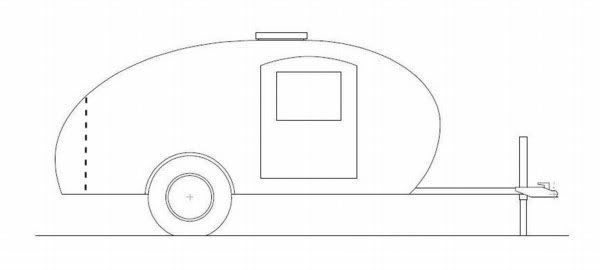

If I do the sides in 5x white (and the roof in red) then I will have only one seam on the side about 1 foot from the rear, not too noticeable.
But then I will have more seams on the roof because of the 4x red (my tear is 5’ wide). But I figure seams on the roof are less noticeable than on the sides. This is the dilemma that I have been tossing in my mind for the past several days and I don't know how I will proceed. Heck, I still may paint the darn thing.
To make a long story short (and to get to the point of this thread), if I do go the aluminum route, how do I do the seams for maximum sealage (is that a word?) but also to make it as less conspicuous as possible.

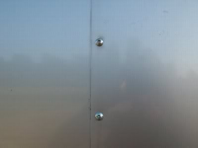

I've seen the thread on riveting and screwing (pic above) but can the edges be overlapped and glued without the screws? I'd like as smooth of a finish as possible but I don’t want the seams popping loose down the line.

...yep and most of the guns are manufacturer specific(3M gun for 3M adhesive...etc.)...which is why I overlap a couple of inches, use an auto windshield adhesive and a row of SS screws...looks OK to me and can you can do a couple or 3 seams for around twenty bucks orso...(12-15 bucks for a standard sized tube adhesive plus screws).....

Sounds good but I think it looks better with plain aluminum. What if you (or I) have white or red aluminum? The stainless screws would stand out unless you painted each screw to match...

How do the trailer (18 wheeler) guys fix those colored panels? I think they are screwed into a metal stud so maybe there are colored fasteners available from them too?
I've spent a fair amount of time in a friends body shop and have seen those two part adhesive guns in action. It is indeed a tough bond, and most cars use that fastening method on body panel/parts. I'd think the flaw with using that stuff is going to be your panel edges. Cars are designed so pieces meet with well thought out edges that look finished or have trim to cover seams. We're usually talking about a much thinner material here, and it's pretty easy to put a small crease in the cutting process when you DIY it at home. That would show up pretty badly on a bare edged glued seam. If you can manage to get a brake cut edge showing at all seams cut by a shop that would help, but you'll still need to be careful handling the panels during construction to avoid a bend or crease. The heavier the panel thickness the mope resistant it will be to dinging up like that, but weight and ease of handling suffer accordingly.
I've been working on my aluminum skin this past week and will be doing more next week, so I'm up to my eyeballs in the pros and cons. I'm using bare panels so screwing seams together looks fine to me. I saw the colored panels a a repair shop I visited and after thinking about it I decided bare finish was easier all the way around. Size availability is greater too.
You're most likely going to have trim pieces screwed on somewhere on your trailer around the doors or some edges. Most trim is bare, so will you have to paint that to match, or will you leave it bare? If it's bare then maybe having screws showing will not look so out of place on seams?

Mark - very nice job on your build so far. I'll be curious as to your solution since I'm thinking about going taller than 4 feet for the sides on our teardrop.
One of the things I've considered is to use two pieces horizotally on the sides butted together at about the midpoint of the trailer. I would then use a trim strip to cover and seal over the but joint with double fasteners
into both pieces. This detail is like the New Cub design in Andrew's design library. If you did something like this you could paint the trim strip white and use a horizontal trim strip to continue the Swiss flag theme. The downside would be that there would be quite a lot of cut-off waste from the aluminum sheets.
Tom[/url]

Thanks Tom. I thought about the horizontal application but I would still have a verticle seam at the rear because my tear is over 10' long. The tape seams like a nice idea also but it's pricey also. And like MJ said, I'd worry about complete sealage. Maybe a tape and caulk combo would work. I still don't know what I am going to do. Painting is still an option I guess although I'm still leaning toward the aluminum. :thinking:
