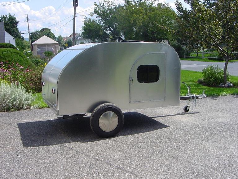

Postby shoeman » Sat Aug 16, 2008 12:35 pm
Just about ready to roll! I put the license plate and light on last night along with the galley struts. We leave tomorrow for a week at our camp way downeast here in Maine. The galley is not fully finished, needs doors and final trim, but since we will not be cooking in it I'm leaving it alone until we return.
Tonight it's a final once over with the caulking gun, put the linoleum floor liner back in and then the mattress.
I towed it around the neighborhood last night and while I only hit 30mph it seemed to roll along just fine.
It needs some spiffy fenders for sure, otherwise I think it looks pretty good. The galley lid side gap is bigger than I like, so that may get rebuilt but it will work as is for a week I think.

Postby Dean_A » Sat Aug 16, 2008 1:00 pm
It's looking really sharp! Nice work.
The galley lid side gap looks good from here!
